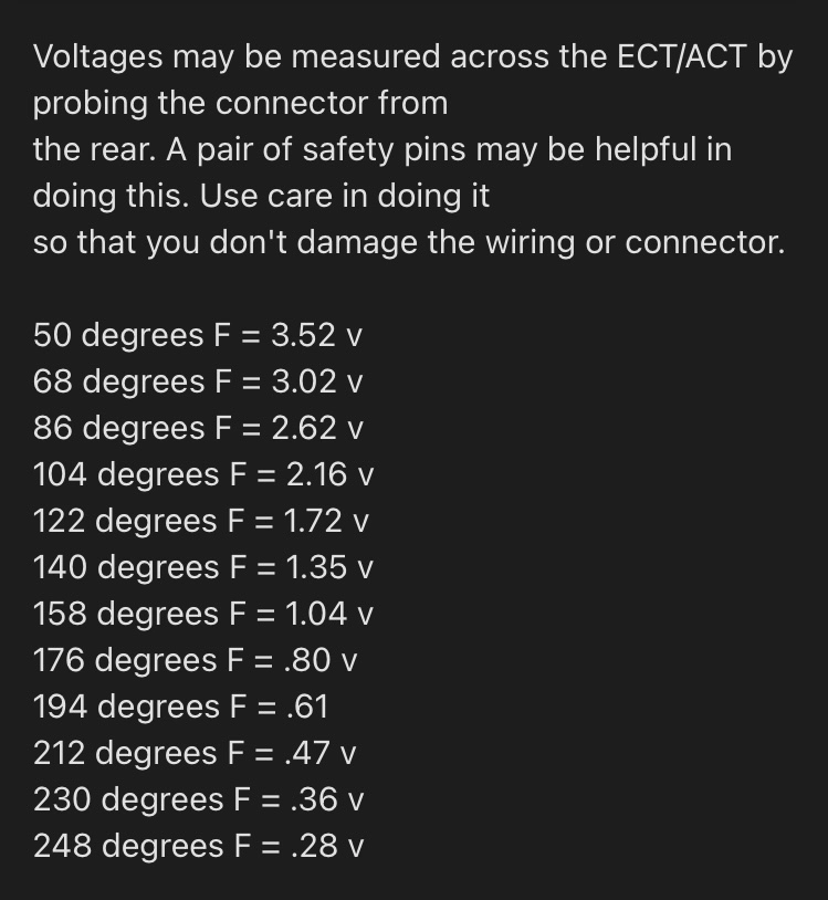

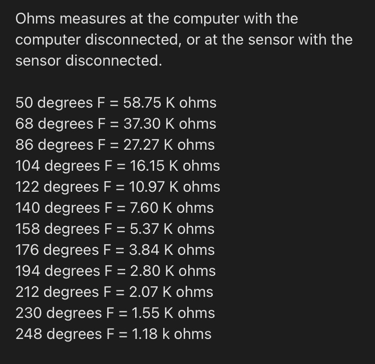

Hi all I'm having an issue with a pathetic MPG and rich condition. I look everything with no success. I'm just working on troubleshooting an issue I encountered at the ECT sensor. The resistance on the ECT sensor is fine from cold to warm and vice versa. The problem I encountered is that the signal voltage coming from pin 7 KOEO is 2.43 volts and not the assumed (At least by me) 5.0 volts. I checked the signal voltage at the TPS connector and it showed 5.0 volts. I haven't checked yet the signal voltage at the ACT sensor connector but I assume it should be also 5.0 volts.
Did anyone had this issue of low signal voltage at the ECT, and how you guys solved that?

Yeah I run a test to the sensor resistance throughout a full warming/cooling cycle and also it’s voltage throughout another warming/cooling cycle and the values on both tests where right on the money. So based on those results I called a good sensor.

So you probably saw this thread which is where you got the two attachments from.
Also in that thread jrichker explicitly says there is no VREF at the ACT or ECT and "Their operating voltage is supplied by the Analog to Digital Converter chips inside the computer."
With that see Post #2 in this thread. This is becoming a common theme with the age of the components of the ECU's on these cars. If you can borrow a known working ECU that would be free and an easy way to determine if the existing ECU is the problem.

Yes I read all of that and made all the sense to me. I have a spare ECU I bought long time ago, it is one of those “rebuilts” sold by Autozone but I opened it trying to identify it because there are no part numbers on the shell, I noticed the known leaky filter so I replaced it. I will swap that ECU and see if I notice any difference.
