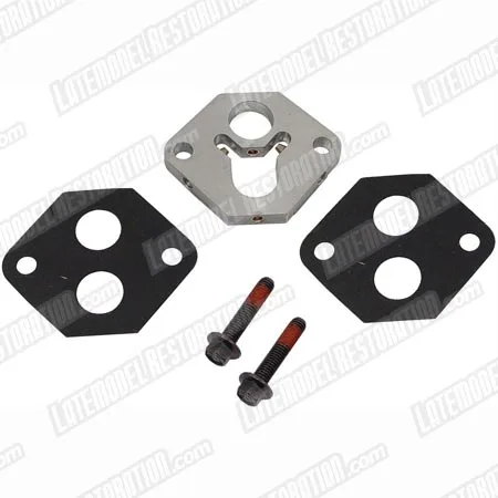

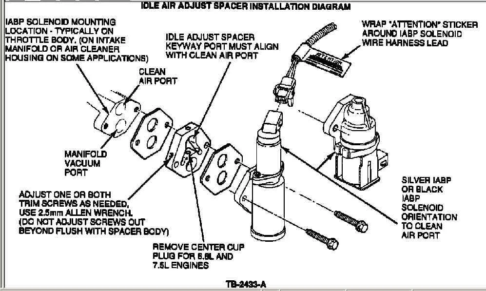

...I've read about the original purpose of the IAC spacer developed by Ford as a quick fix to dirty throttle bodies, and how some guys use it now to fix idle problems....
FYI, it called a Ford Idle Air Adjuster Spacer & that's exactly what it's used for then & now.
I bought one a while back, it worked, but don't need it any more.
