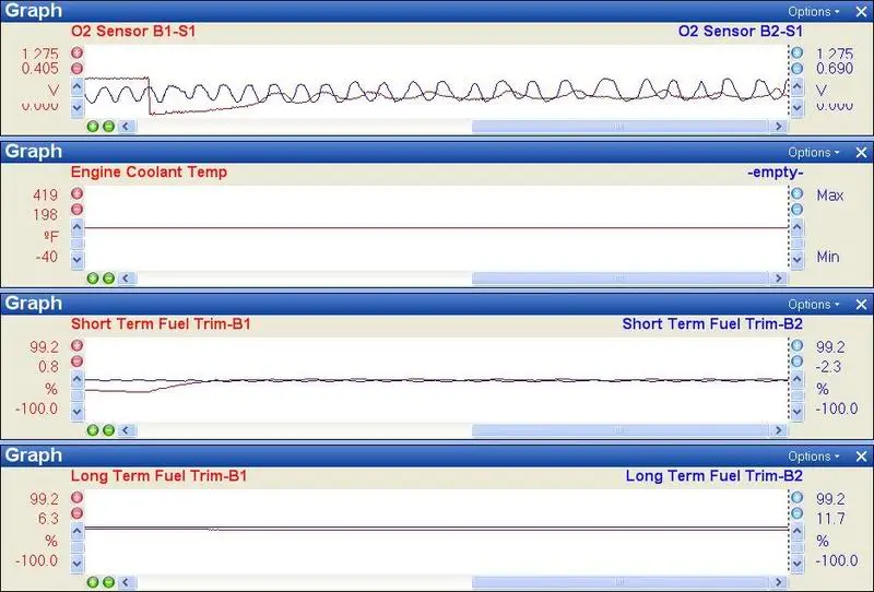

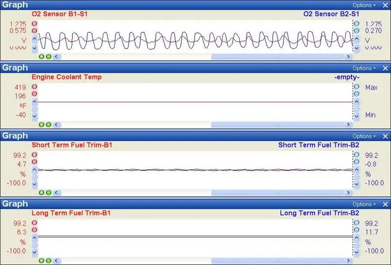

check it out, i did some datalogging, since i changed the bank1 o2 sensor already, so thats not it. i am thinking it could be a problem with the o2 extension wire, it seems like the heating element in bank1 sensor isnt working! in one of the graphs you can see that it warms up and starts working better after i rev it up. im gonna try and get one tomorrow. what do u all think?
after looking at those graphs the bank one 02 is acting very odd. now if I am reading your graphs right they start at a engine temp of 190 and end at 198 so these were taken with the engine warm. Was it running rough when you took these?
the first and the forth graph are very interesting.. in the first one you see that the pcm is adding fuel like crazy to try and bring the mixture back to stoch at this point both 02's are not switching. at the end of the second graph the bank 2 o2 sensor starts to switch.
the forth graph is kind of interesting. If you look a 1/4 of the way into the 02 sensor graph you will see the blue line start to go nuts. this is what happens when the pcm is confused and as a last ditch effort before jumping into open loop it tries to correct the bad readings by projecting 02 sensor readings. The reason I find this very odd is that it's doing that on bank 2 the one that is switching fairly normal. most of the time you see this the pcm will do this on the bank that is not responding well.
I think what you need to do is try to help the sensors warm up quicker by using header wrap or some other way to increase the sensor temp. the problem with headers is they move the sensors much farther downstream than they were in the stock manifolds.
in graph 4, i revved the engine up a bunch of times, that is why the bank 2 o2 sensor reads like that, i was trying to get the bank 1 warmed up enough. the car was running rough for a little bit of this datalogging. what i dont get is, the bank 2 sensor heats up fine, but the bank 1 sensor doesnt, and they are both the same distance from the motor and in the same shape/size header. this car has heated o2 sensors. this is why i am kind of thinking the heater is not coming on in the bank 1 sensor, and it is only getting warm from the exhaust. im gonna try a different o2 extension on that side.

the bank 2 o2 sensor reading like that is not caused by revving it up. That is built into the programming of the pcm and is used as part of the PCM strategy to try and correct itself when the 02 sensors are not switching properly. This was taught to us in one of the driveability classes
Even with heated sensors ( all modern EEC systems use heated 02's) when you have long tubes the sensor is moved further away from the head so the exhaust gas temps are a lot cooler there then in the stock 02 sensor location. Since the sensor heaters were designed to heat up the sensors in the stock location they are not capable to bring the sensor to the temps needed for proper operation when they are moved to the location they are in your headers.
One thing that could cause one sensor heater circuit to not heat as much is if you had damage to the heater circuit of that 02 sensor. Now the damage would have to be in a way that you would have continuity on the heater circuits but not be able to carry enough amperage to light off the heater correctly, if you had a wire with only one or two strands left could cause that.
Well good luck, keep us posted
