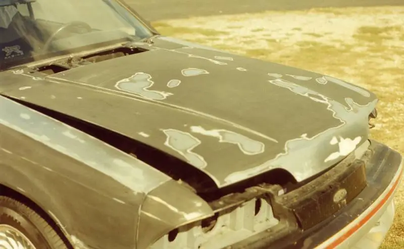

Yep, you have to feather out the spot otherwise you will see the spot when it's painted.
The picture below will show you how much I tried to feather out the messed up paint on my ex-stang. Ended up taking all the paint off because I couldn't get it to feather out enough, but the original spots were about the size of a quarter.
