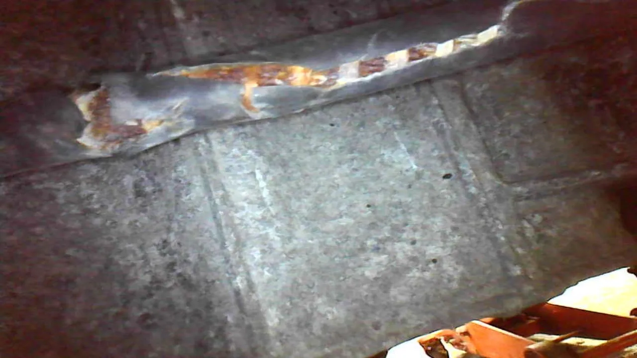

I had my clutch done a while back. It was sounding horrible, screaming on pedal down. Definitely much better since but now there's a chirp only when the pedal's up. I took a look underneath and the clutch cable is bursting with rust. Any chance this can be the cause? I'm hoping I can replace this and solve it without having to pull the tranny.

Yeah, it goes away with a little pressure. For the retainer, I'm guessing the tranny's still gotta come out?
Yeah that sounds like it’s the retainer the TOB rides on. Correct, tranny has to come out. They can run quite awhile with the chirping thiugh.
