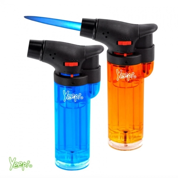

If it's in a tight spot, a trip to a "smoke shop" or the internet for a blowtorch lighter can do the trick. I keep one in my toolbox at work to heat up stuck fasteners and for heat shrink in places I don't want a heat gun.
As small as the flame is, it can take awhile to heat a bolt up, but it does work. There are bigger torches out there that are still pretty small, but these aren't much bigger than two D-cell batteries.
There are refillable butane torches at HFT and cooking stores that are a bit bigger but have a small, hot flame.
One of the blowtorch lighters should go in my portable repair kit.
