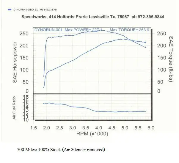

Here's my dyno graph: 700 miles on the car 100% stock w/ air silencer removed
So it's about 12-13% loss.. for my case
