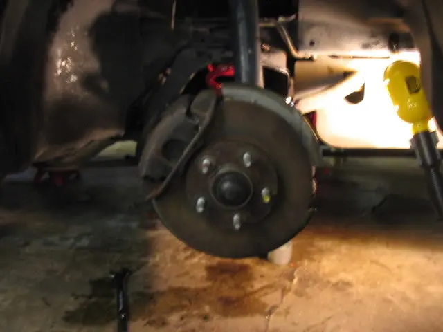

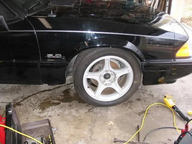

:mad: figured good a day as any to put on the new brakes. yeah that went fine. sit it back on it wheels and now im just frustrated. now my fenders are on my tired, the tires are both pointed in and i dont feel lik dicking with it anymore today. so now back on the jack stands to goes so ic an try and get the alinment as best i can to where the wheels are pointed foward and not in. and these sportlines. **** these springs. there coming out and never going back in :mad:
way to ****ing low
welcome to my world. i have sportlines also, an i tuck just as much wheel as you do in the front with 225.50,16s. idk what size tire to go with up front with 17s. i rub baddddddd! with the tires i have on the stock 7 inch wide rim already. kinda why im stuck on goin with pony r's because they have 6.5 inch fronts available. luckily i didnt buy the springs but i feel your pain. did i mention i have stock original struts up front still?? buyin new ones this week, thanks to tax refund : )

What year sn95? Don't some push the wheels out?
95. and yeah it pushed it out some thats why my fenders rub.

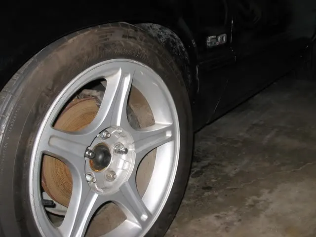

All you need to do is turn the tie rods out more ryan. On my black notch with 95 spindles and fox inner and outer tie rods, I turned the outers out 17 times per side to get it to the alignment shop.
yeah had to spin mine about 10 times on passenger side and two on driver. went and got my new lowering springs. now to go put them in. eibach are already out.
Quick and dirty toe in check:
Clamp an ice pick on the front part of the fender well so that the pick point scribes a mark on the tire. Rotate the tire so that the scribe mark is all around the tire. Do the same thing to the tire on the other side.
Use a tape measure and measure the distance between the scribe marks at the front of the tire. Then try to measure the scibe marks at the rear of the tire with the tape. Measure the back side of the at the same height as when you measured the front. More distance at the back means toe in, and less distance at the back means toe out. You should shoot for 1/16"-1/8" toe in.
i usually have a friend hold a tape measure on a certain part of the tread and i do the same on my side.. measure. Also you want to turn them equally, 10 times on one and 2 times on the other side is a bad thing, they should be even.. i would start over with the toe adjustment or your car will turn farther one direction than the other(in parking lots and such)
