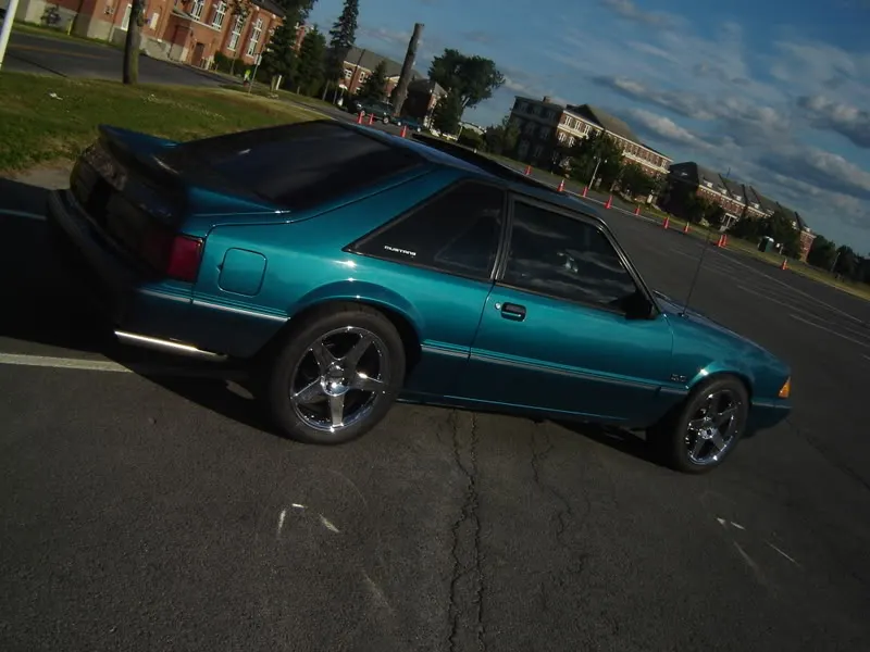

Quietest setup I have heard was : MAC 1 5/8 shorty, MAC ProChamber, Dynomax Super Turbo 2 1/2" catback.
The car ran 9.8@142 with this exhaust in 100% street trim, stock pony rims with 255/50 Hooiser Drag radials. I have pics of the car somwhere on my laptop maybe in my photobucket. The car was a TOTAL sleeper other than the SC whine. It looked all stock. Not one single gauge inside and nothing to make it look overly modded.

I can get some better pics, I know I have more of it when we 1st installed it.
