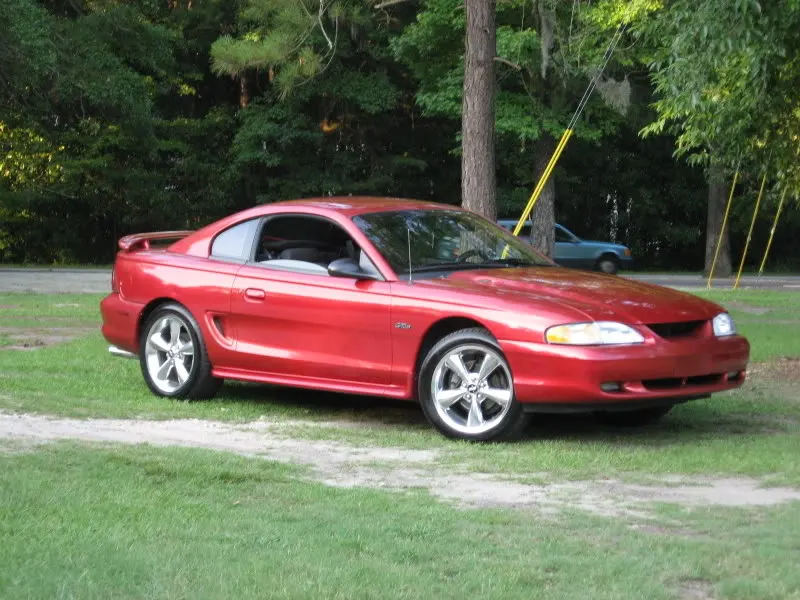

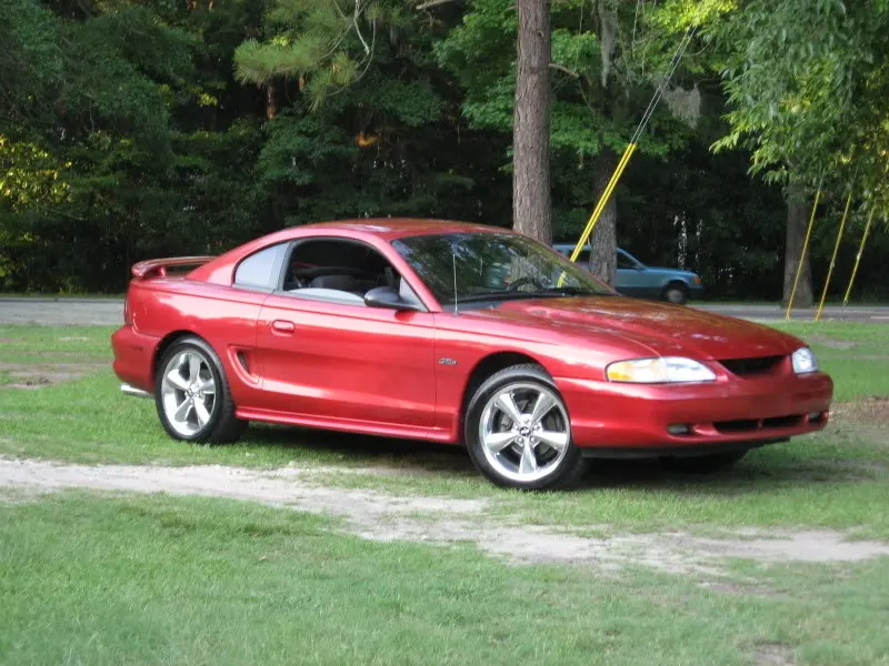

i had 18" polished prems from a 06 gt on my 98.. 1" spacer out back.. 5/16" up front
they fit.. only rubbed on the front, but its about the same rub i get with 275's on 95 cobra R's
