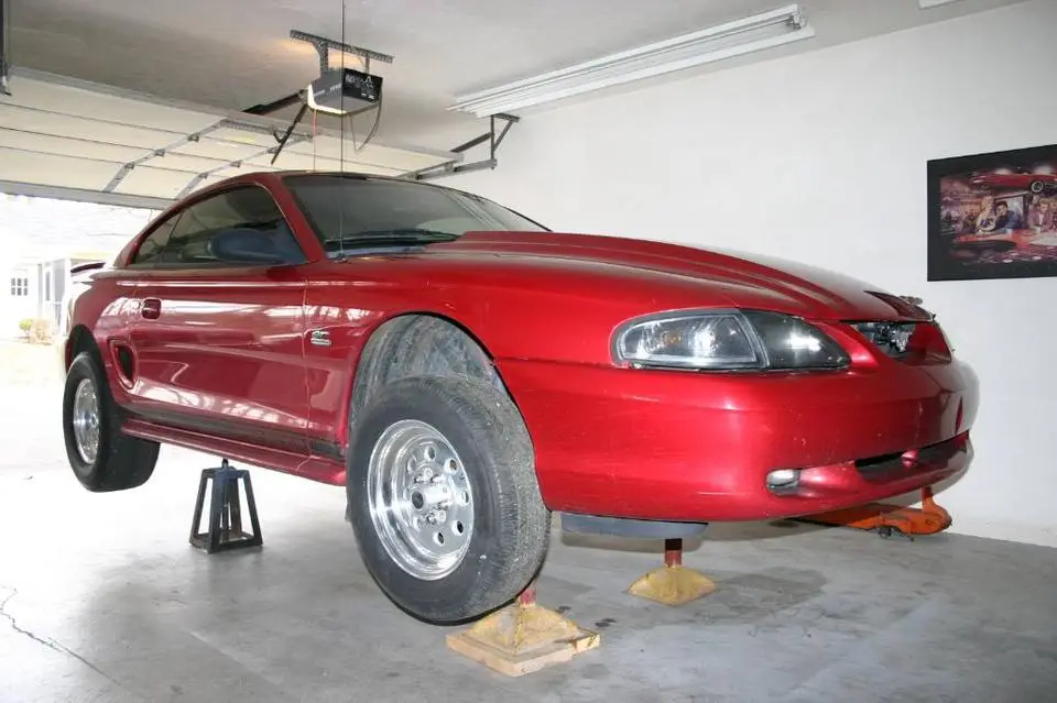

I am not a novice around the garage - I have pulled and installed many an engine and transmission. However, in the past if I needed to elevate the car, I was able to support it by the tires. I typically jack up one end of the car, slide some spare rims under the tires (upside down), then lower the tires into the recessed back side of the upside down rims. I like this method, because you can tell just by looking that the car is not going to “rock” itself out of the upside down rims and fall on you.

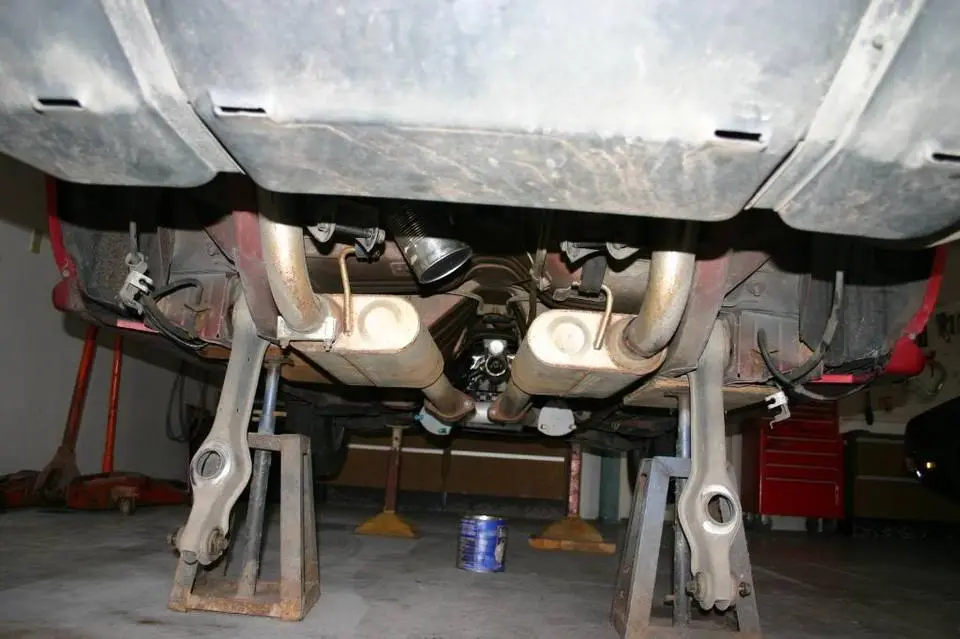

Two under the rear end, one on each end far enough away from the ends to allow room to work on the rear brakes, like 6-8".

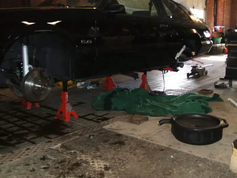

On the front, I put the two jack stands under the K member very close to where the A arms mounted, as far apart as possible. Then to remove the spindles (SN95 brake swap) I used a jack to support the A arm as I lowered it to remove the spindle from the ball joint.
If you are just doing rotors, keeping the Fox brakes, then you can put the stands under the A arms just fine.

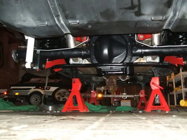

Best way to support it is to put the stands under full length subframe connectors if you have them. That way they are not in the way at all.

Some ideas that might help. Just put a TKO in and about to install the 9". With doing the 5 lug convert up front you may want to go a different route than me, or maybe do one end at a time.
