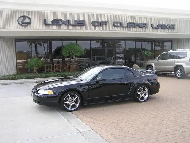

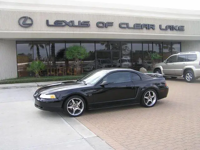

Its hard to tell on a black car, but you can see the front is higher than the rear. Its gotten worse than that too. I'll get pics up as soon as i get a hold of a camera

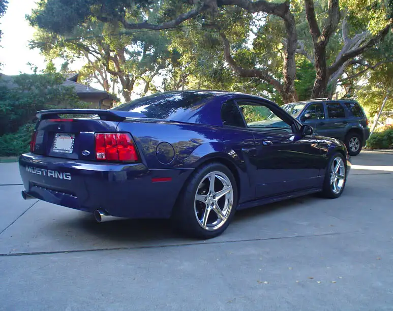

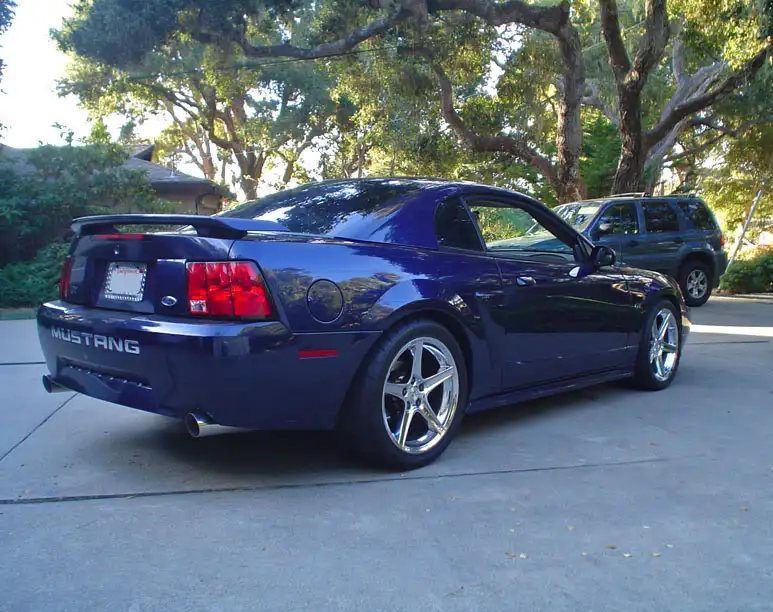

i bought roush springs for the rear cuz they were cheap and i could find just the rear springs easily without buying all four.
They didnt raise the back as much as i wanted them to tho. I really wish that i got some rear Steeda sport springs to put back there.
and mity2....i posted a pic with the roush springs in on the other forum, but im happy to post it again. The new rear roush springs probably lowered the rear about 1.6" i'd say total....they lifted the ear by about an inch from my sagging sportlines.

i bought the ones that advertised 3/4" and look (earlier on this page the pic of my car) at how my rear end sits with them....it ended up lowering the rear about 1.5 or 1.6 inches. its weird how they do that, but roush springs have a problem with sagging also....the only difference is that they start off a lot higher than the sportlines so after they settle and sag a bit, they are still higher.
