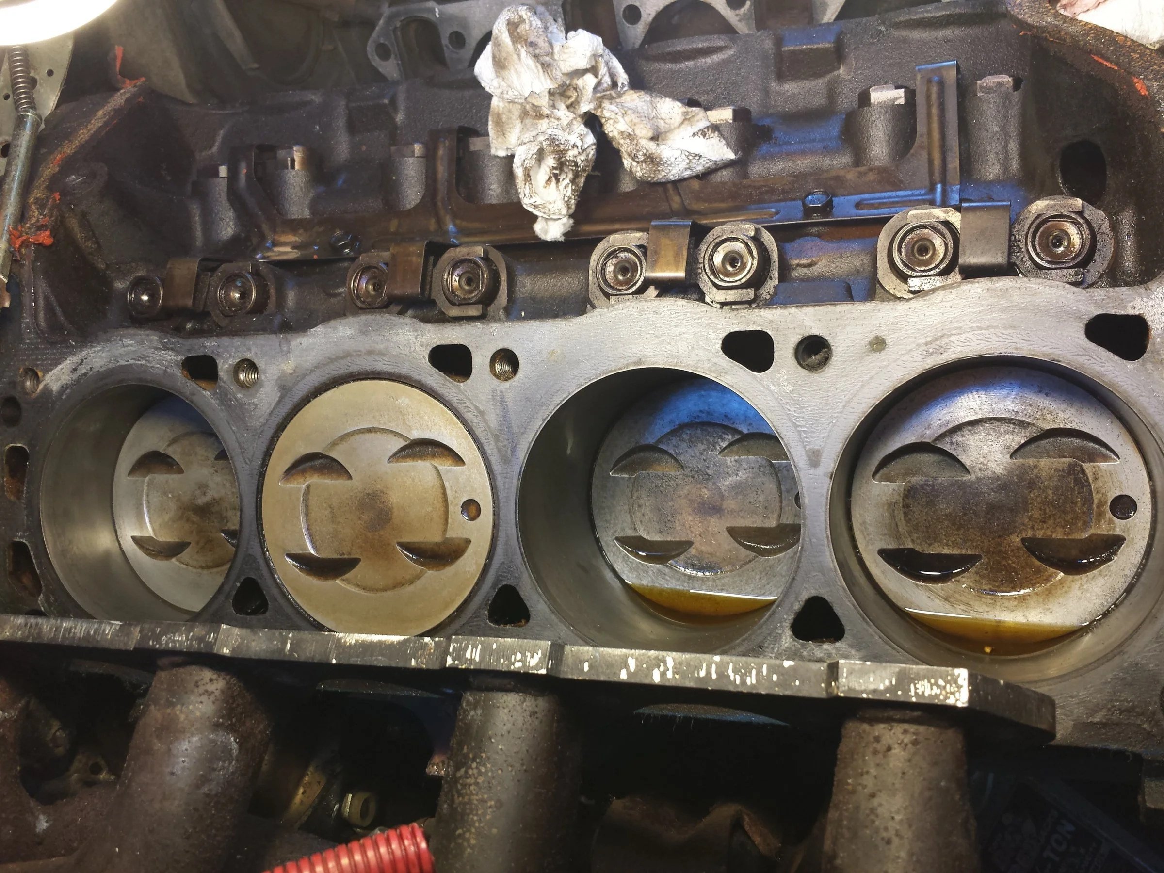

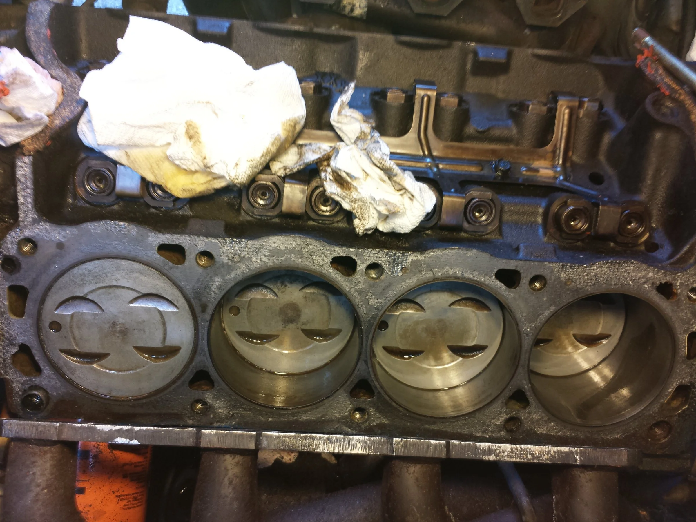

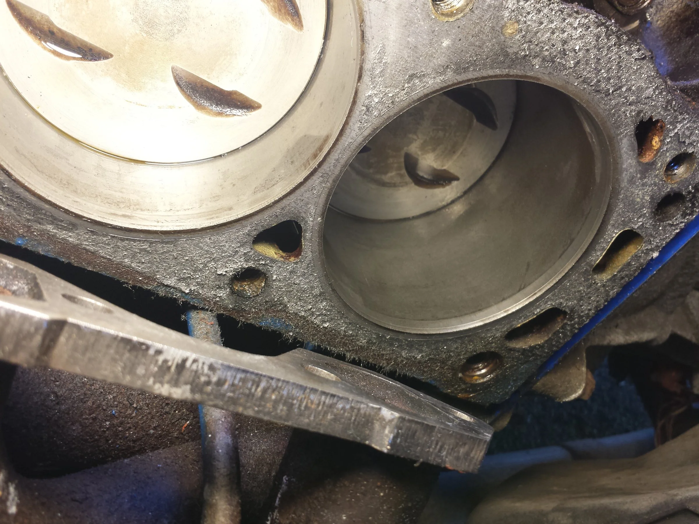

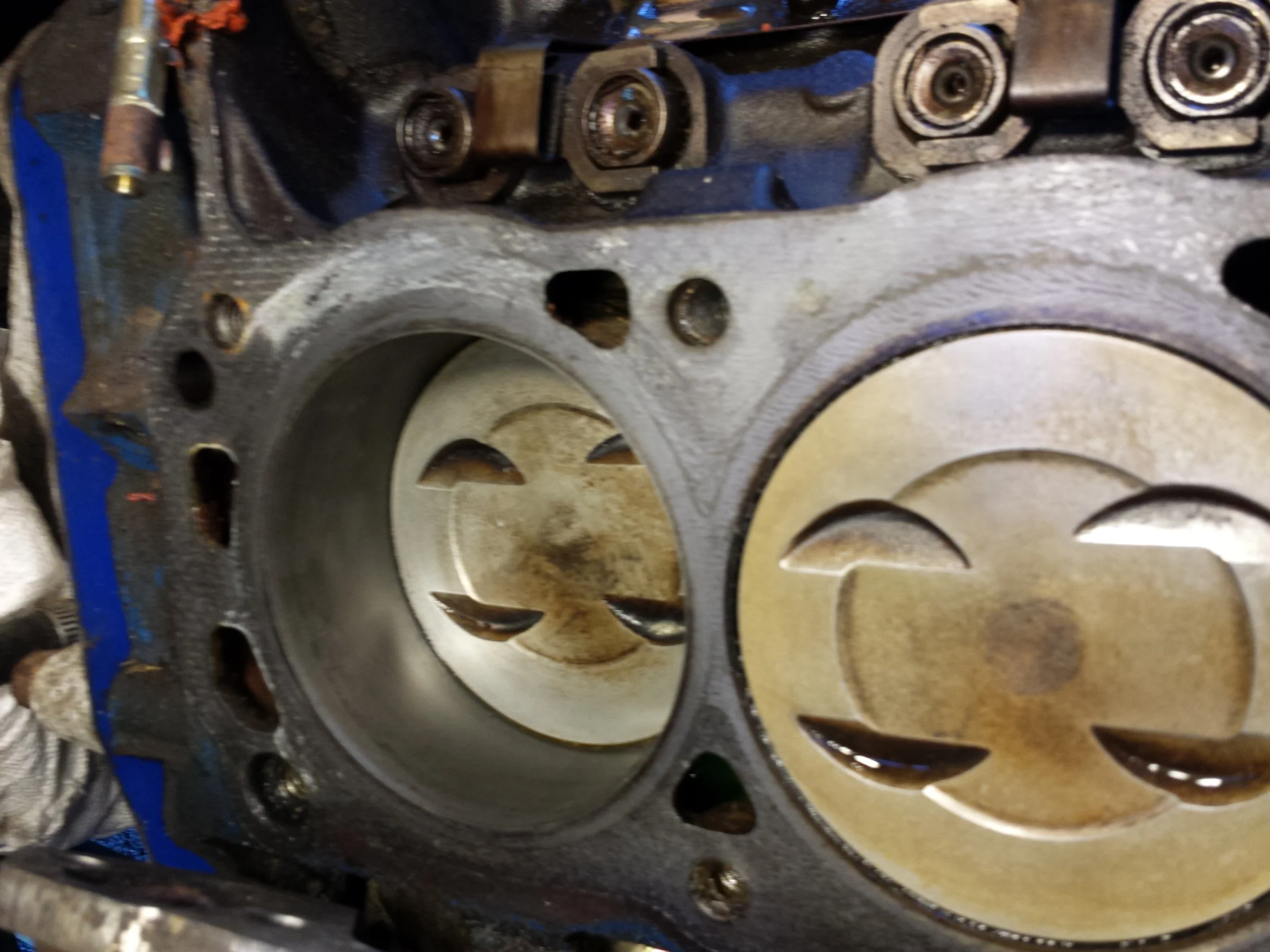

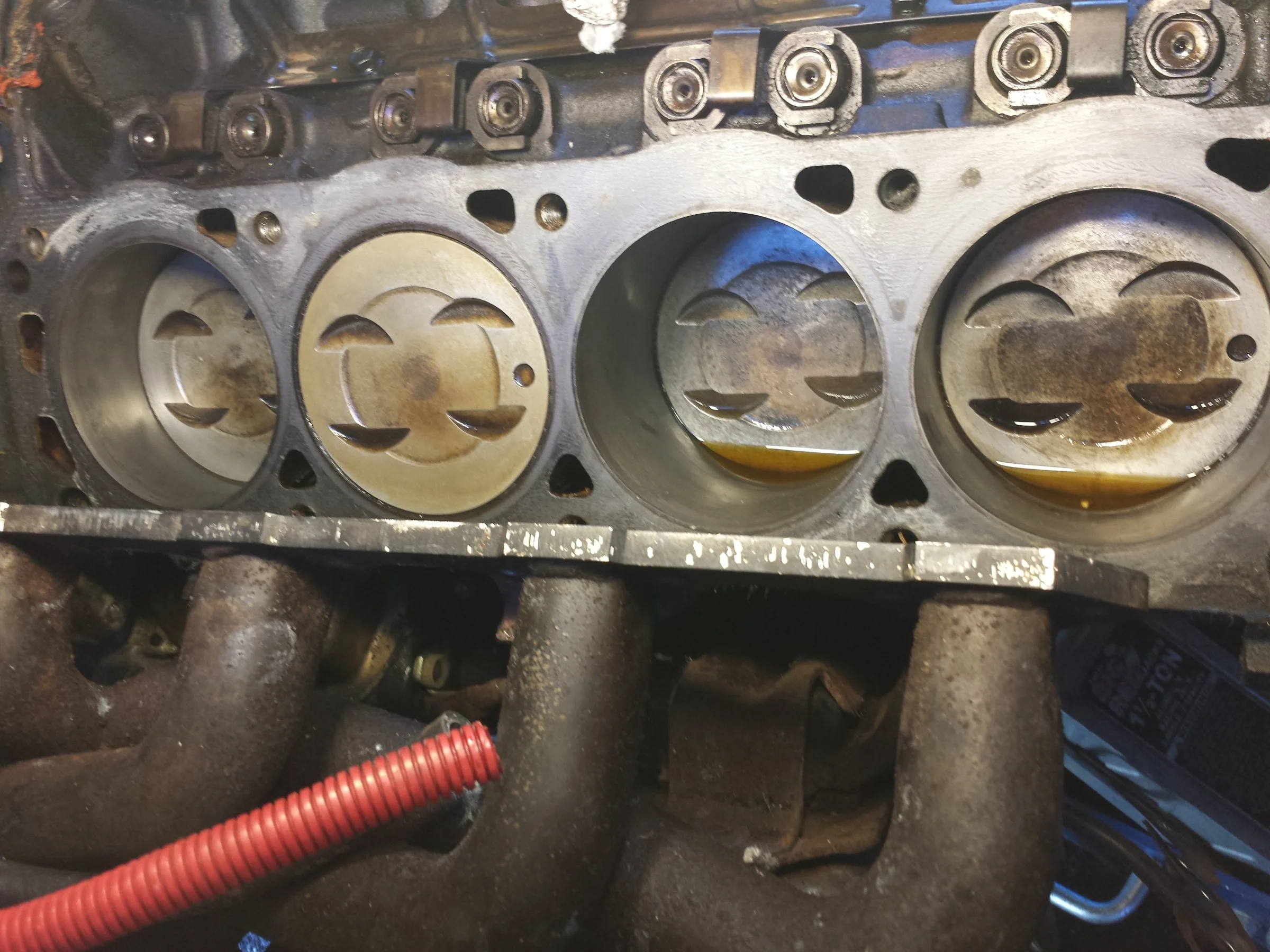

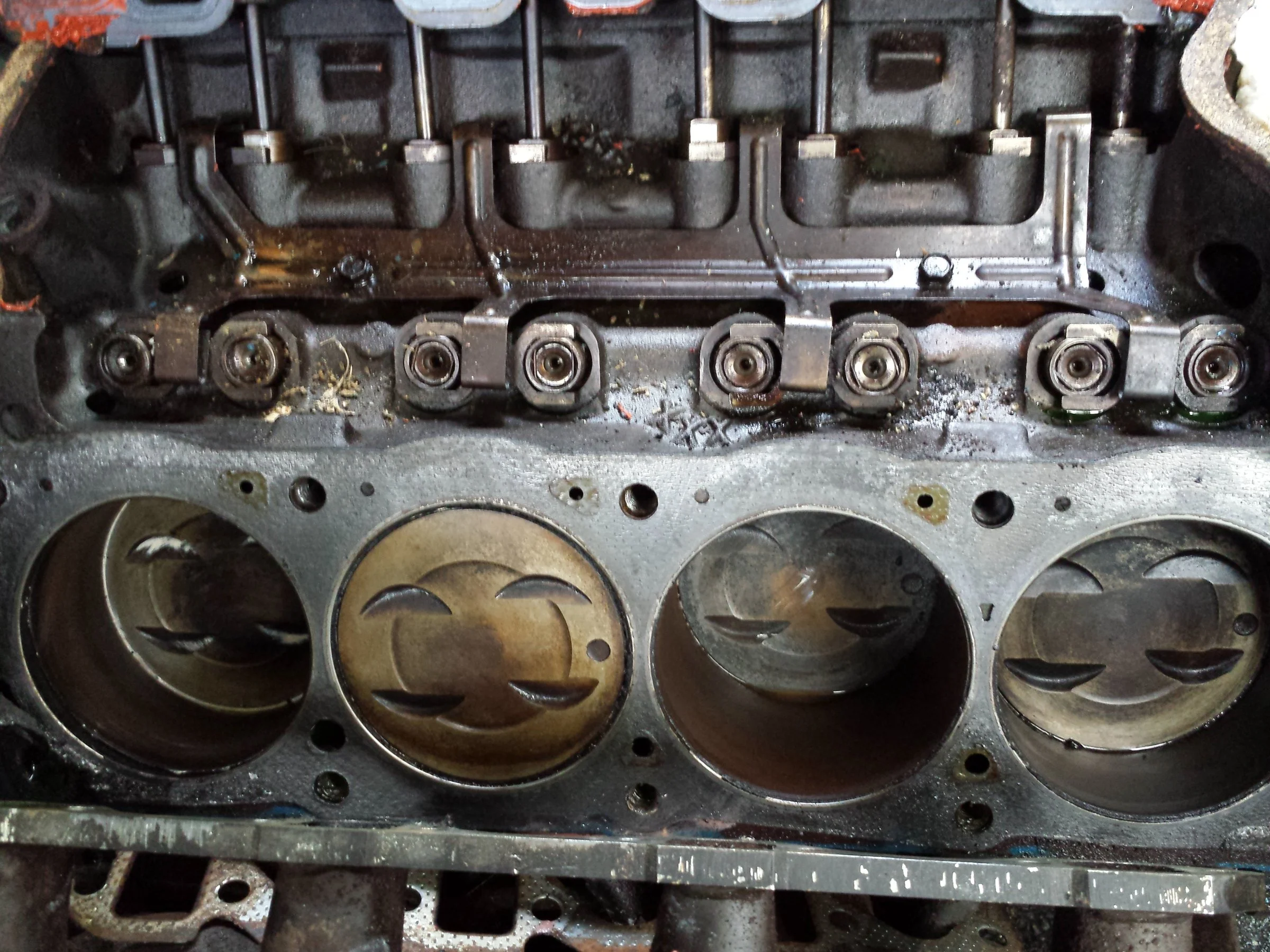

I removed the heads.

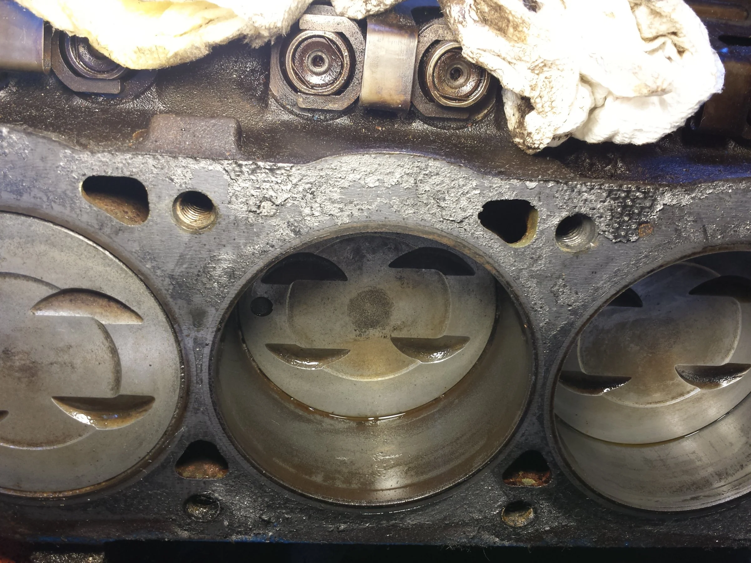

There was a tiny amount of surface rust on some of the cylinder walls which was easily removed with steel wool and naval gel. The walls are as smooth as anything. no pitting or scratches.
I then used a heavy hammer and block of wood on all of the cylinders.
No movement.
I don't get it, if there was water damage causing this, shouldn't there be some sort of visible evidence?
Moisture develops in the cylinders and rusts the rings to the cylinder. Makes them stuck like chuck.

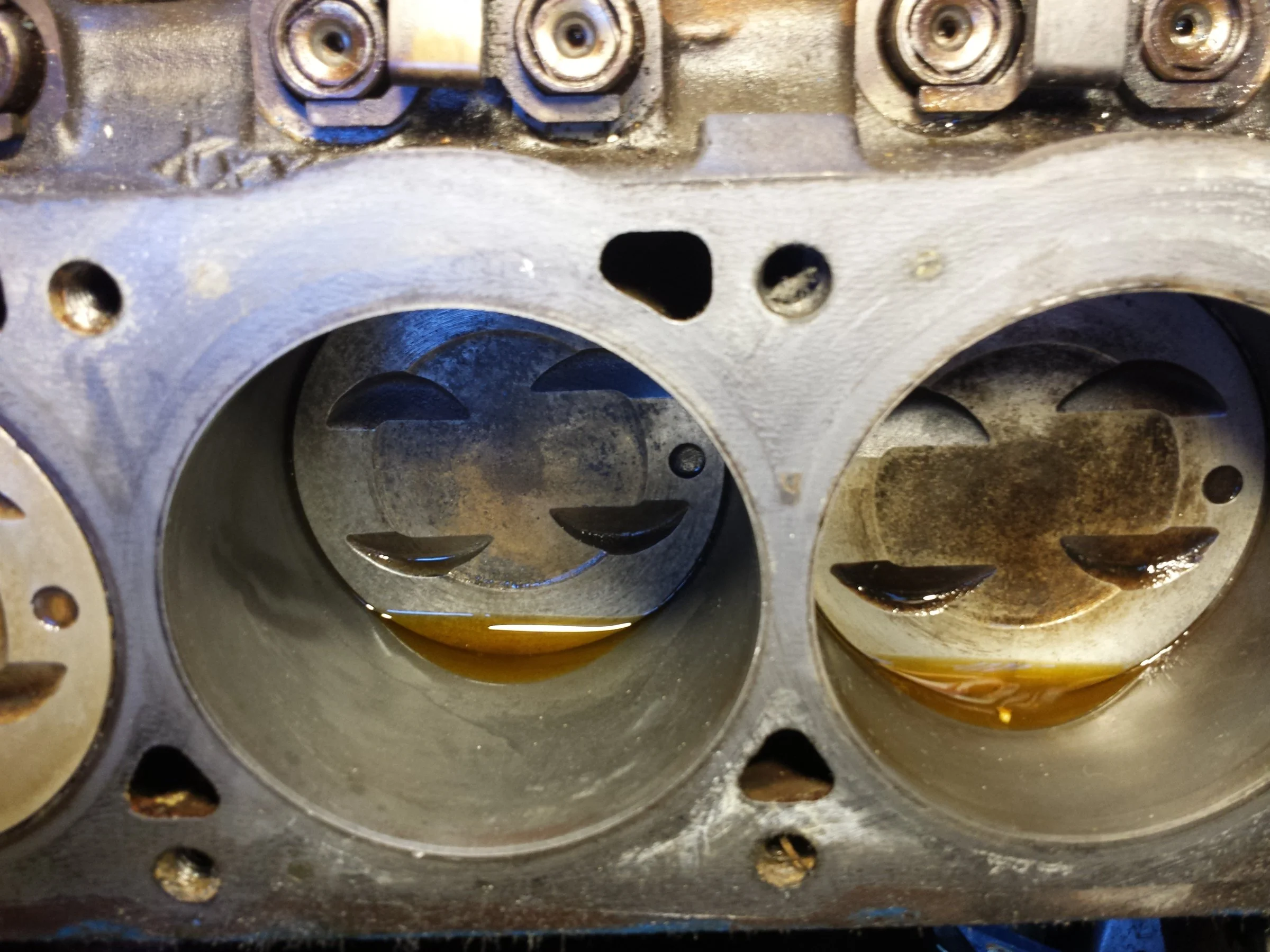

The First pic is before I started cleaning them out.

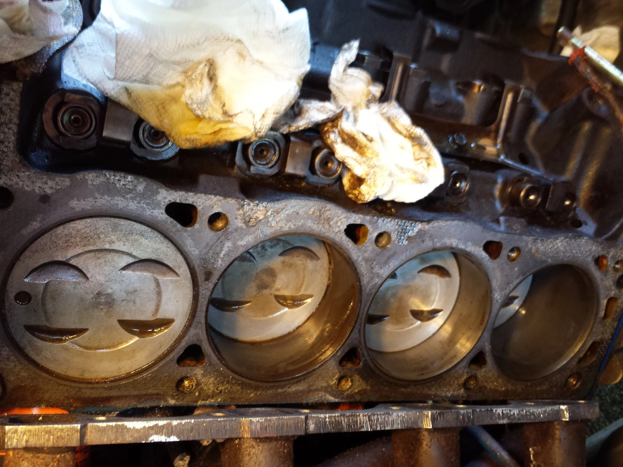

I know I still have to Finnish cleaning a couple of them.

Looking under the spot where the pistons were stuck is gunky rings but not really rust.

I don't see crosshatch though. I've torn apart numerous 302s and nearly all of them still had visible crosshatch pattern. Based on that alone I would be inspecting Cam and rod bearings.
