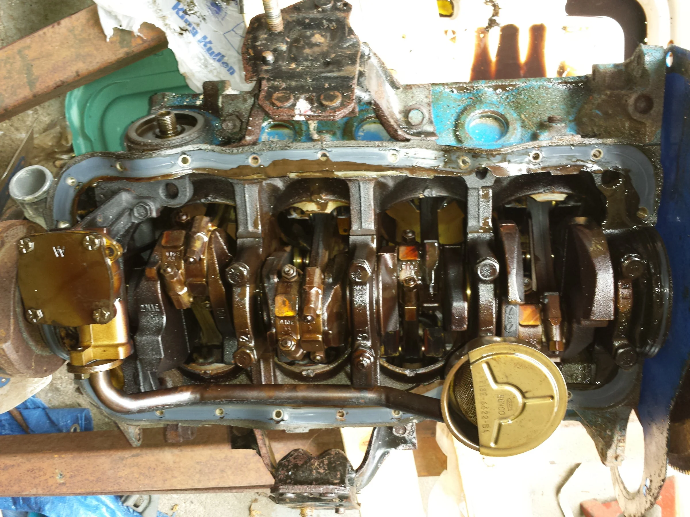

Update: Sorry it took so long but today I got some results.

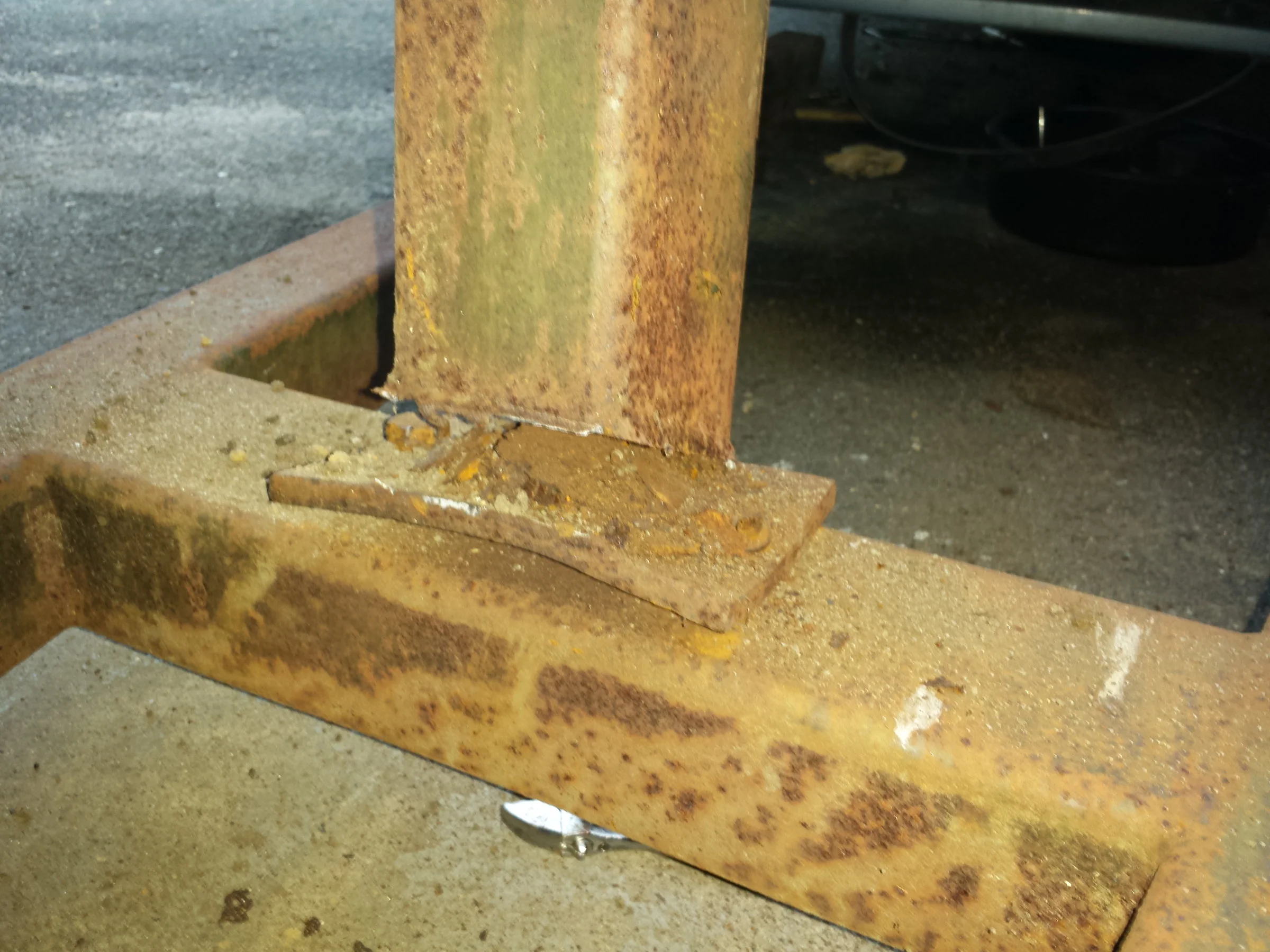

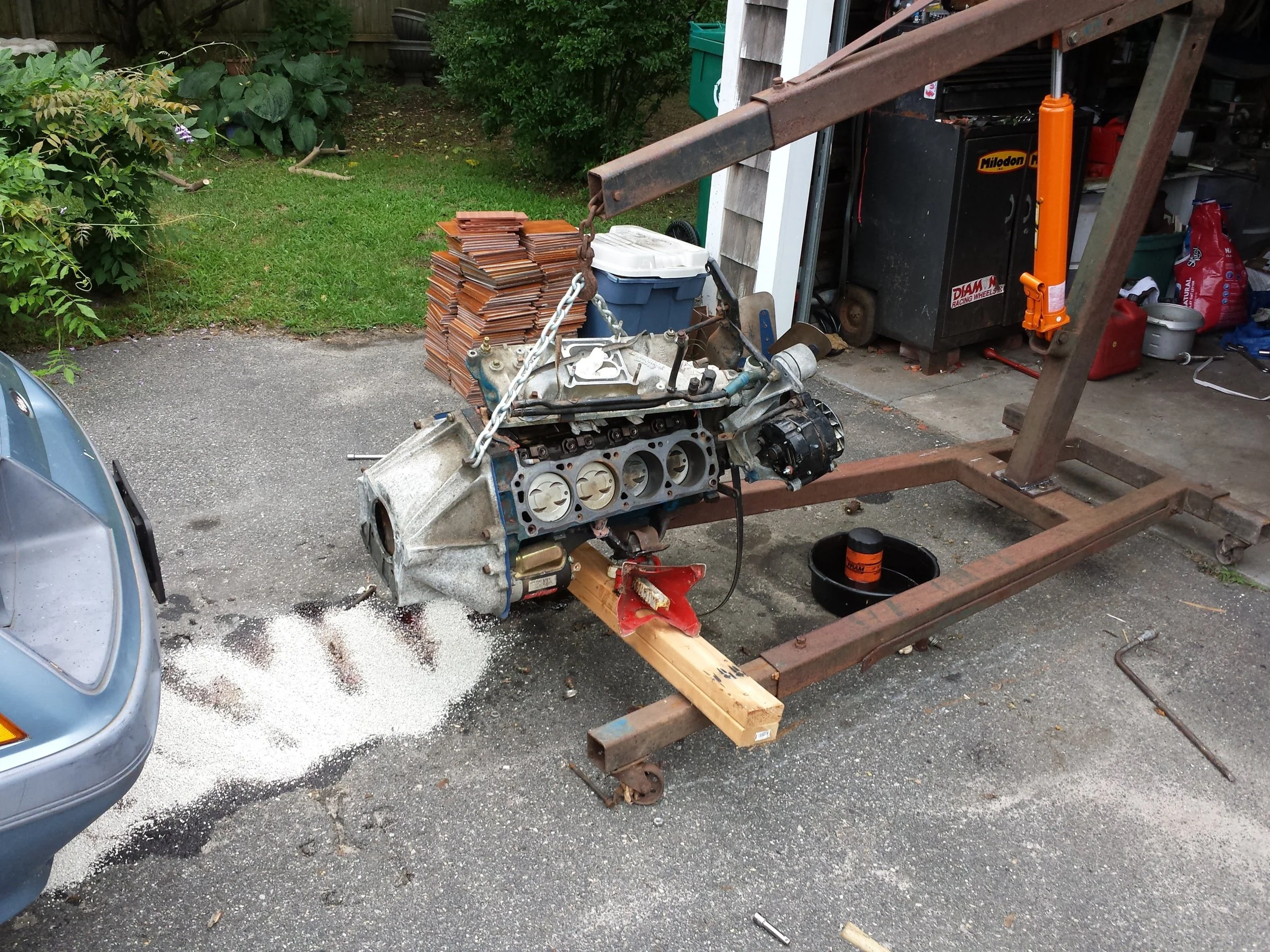

So long story short, I had to get a new piston for the Hoist, $65 at HF. The weld for the spine of the hoist then broke with the engine barely raised, thankfully, $40 at the steel shop. got it out+began tear down.
Took oil pan off and used a feeler gauge to check the rods and was within spec, about .0015, .0020 on the rear pair.
I had not taken the crank pulley off yet, I decided to try and get the pistons out.
I began at the rear and worked my way forward.
I was ably to get the crank to move about a quarter rotation backwards and clockwise, but it took a lot of force.

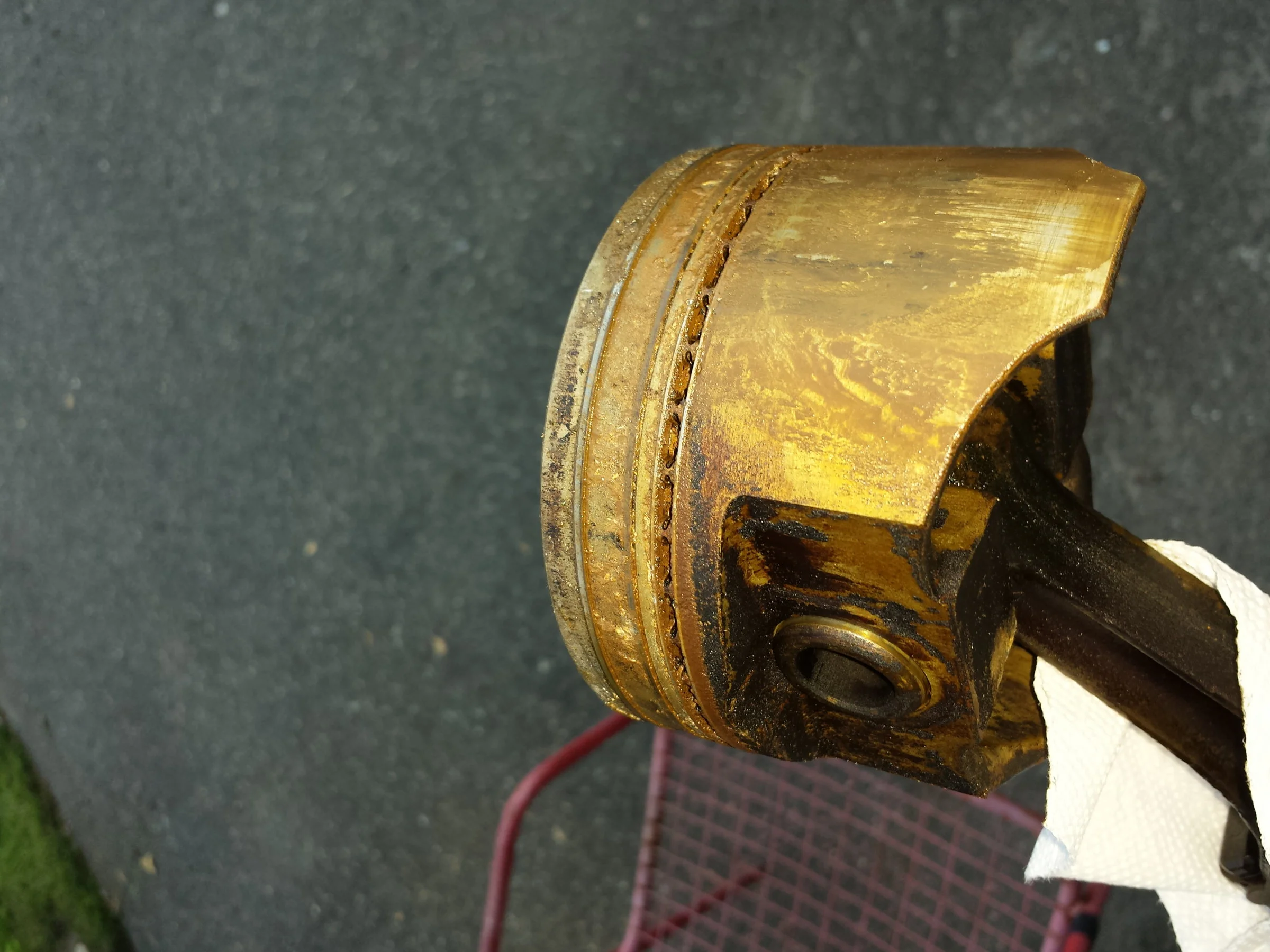

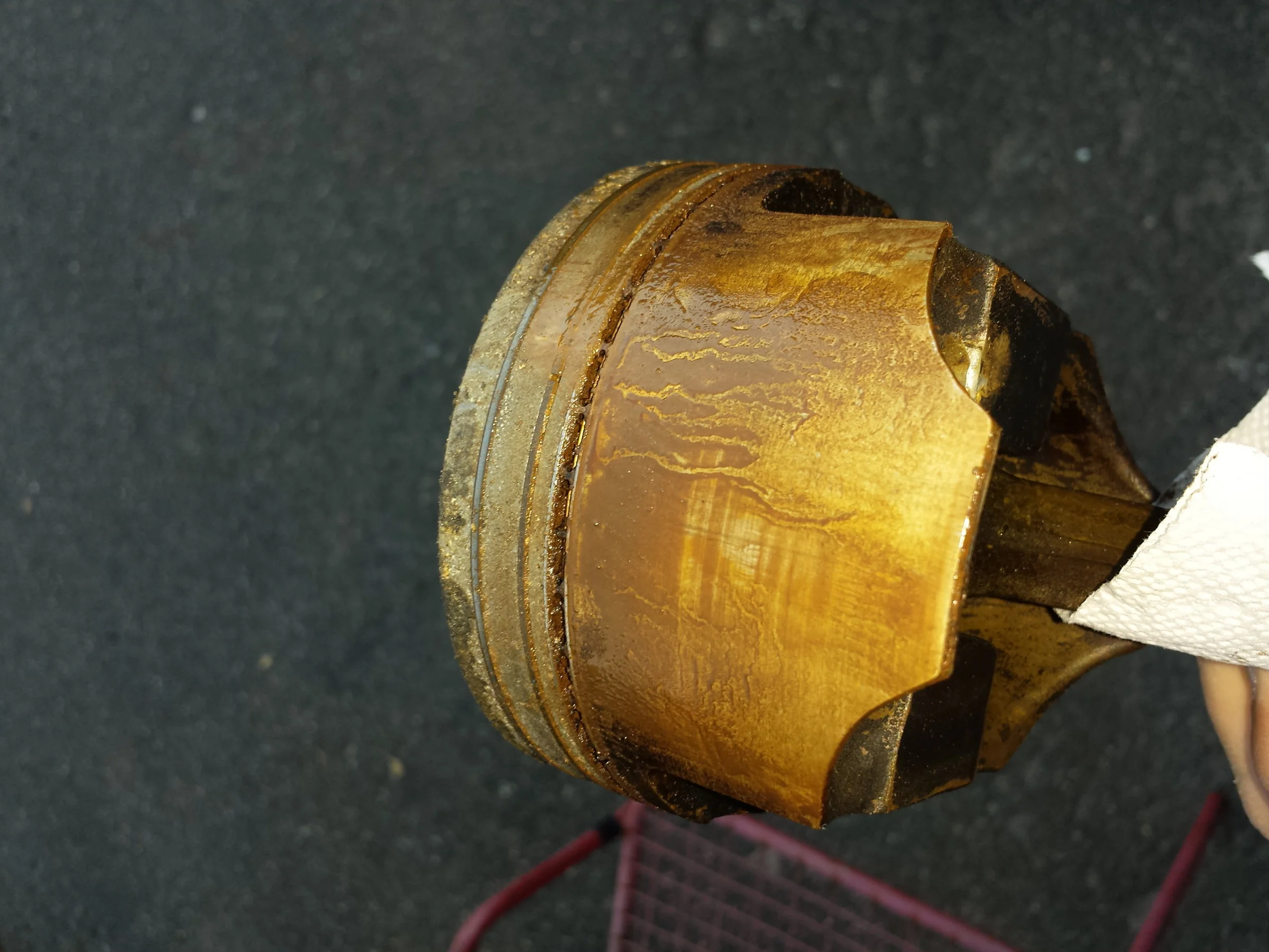

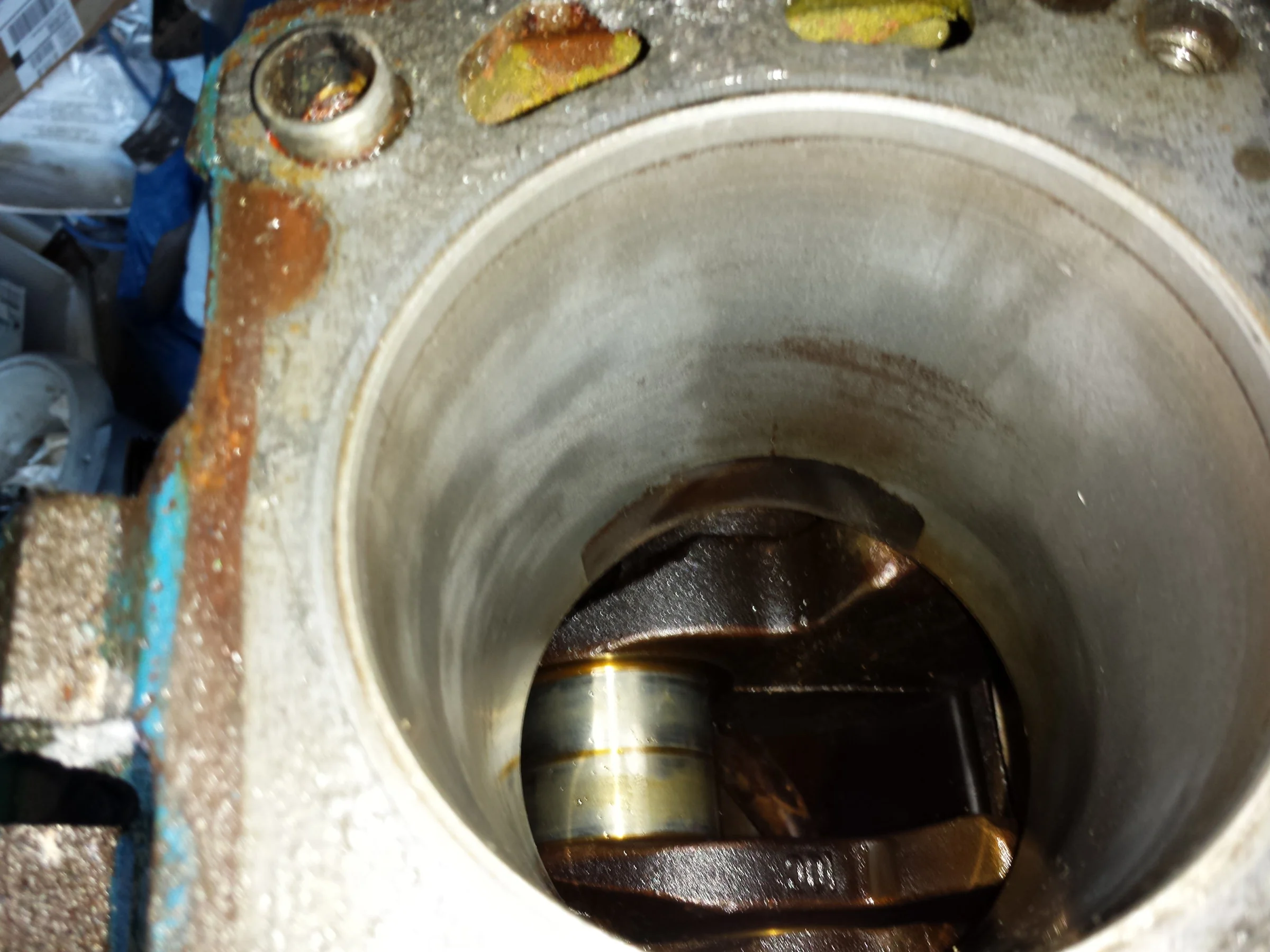

At no point did it break free. Finally I was at the last piston, drivers side front of engine. It was particularly difficult to get out, but nothing crazy. It appeared to be a lot of rust as I removed it and what do you know the crank began turning, like butter. The cylinder had some rust but nothing crazy and some steel wool and phosphoric acid gel took it right off.
It cleaned up nice, need to give it a good hone, It may have been more carbon seizing it up, there's still some stuck to the wall, I didn't mess with it much yet.
So at this point it looks like everything can be reused, I may as well replace all the bearings and whatnot. I am going to look into some cleaning process that a speed shop may offer. Gonna look into that now. Maybe I should make a new post to ask a few questions on that issue. I saw summit had a kit fairly cheap.
Apparently the project sat so long even the tools began to fail ><
Murphy's Law
Yea it's filthy but all that stuff seems to be washable, messing with it tomorrow.
Thats carbon on the wall, not rust.
I don't think carbon can build up on the cylinder wall.... the rings would keep any combustion carbon above the top ring... that's rust for sure. either way have a light hone done new rings and bearing [ I suggest KINGS bearings more babbot no copper]
