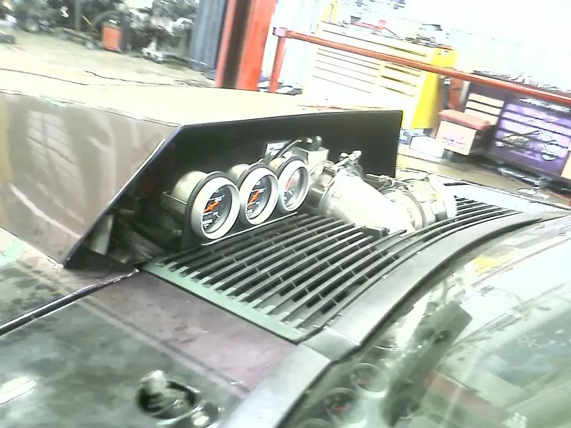

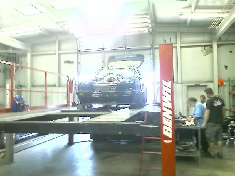

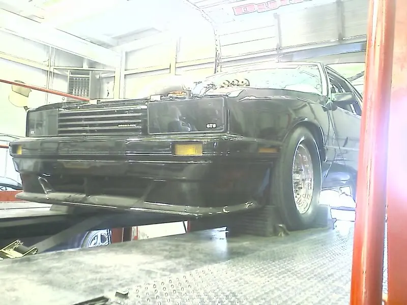

definitely possible. last time i had my car dynoed, i was inline behind a guy from arkansas with a capri RS....thing had a sbf with an F1 procharger. he was there doing a street tune (he was about to do a "true street" event where he had to drive 100 miles between tracks, to 3 different tracks), but on the last pull, the tuner put a lot of fuel into it and he laid down 1247rwhp. don't know if he made it though, lol. i don't remember exactly, but he was pushing somewhere around 26lbs of boost, maybe more. LOUDEST car i've ever stood next to. it was ridiculous. kinda funny because when ryan stomped on it, everyone had to plug their ears, but the old guy in the blue shirt in the first pic just stood there doing his thing, tuning the car like nothing was happening. hahaha.
