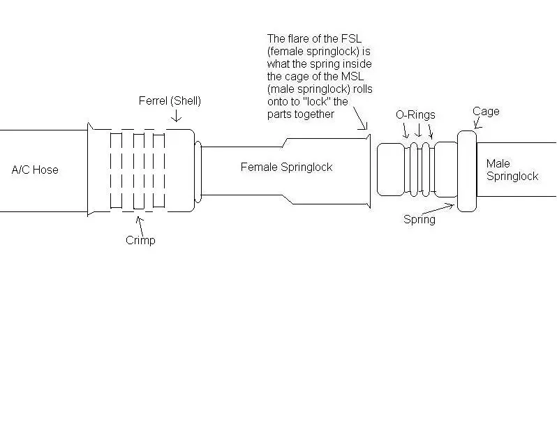

Hissin is right about both. I can tell by the question you aren't but once you are fimiliar with springlocks you don't necessarily need the tool. A flexible piece of plastic works fine in a bind ( I make ac systems for Ford so I know all kinds of little tricks). Springlocks are used on fuel lines as well as ac lines. The tool essentially slides inside the cage of the male and pushes the spring off the lip of the flare on the female springlock, which unlocks it. You can get either at a parts store. Here is a diagram of the ac springlock which is basically the same as the fuel one. btw sometimes the spring gets corroded and stuck and can be a pita. Goodluck.
