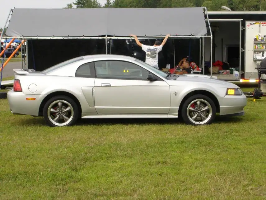

Here's a pic of each, which would you rather have?
Because it would probably look almost just as good. Especially becuase If i want to go with the fronts like mustang 5l said which is the other thing i considered, I wouldn't wanna leave the back puny ones, i just dont think it would look right IMO. :
It's not that noticable. I hate how small the rears are, but i'm too lazy to pull my axles to install the rear cobra brakes. :shrug:
