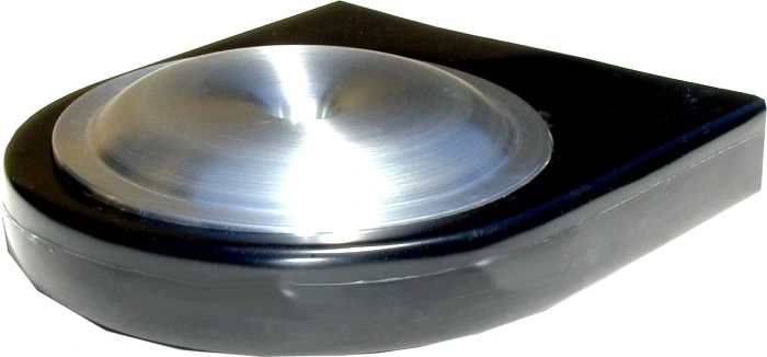

If you go the cowl route, you may be interested in one of these from Delta Bay Mustang. It appears to be very functional; relying on the high-pressure zone in front of the windshield to provide a cool air charge directly to the carburator.
