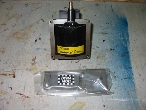

I installed that ignition system during my H/C build...no cpompaints...think i pd 276.00 shipped for the entire deal, including the billet wire looms...it does have a fatty spark...plugs gapped to .060

I ordered the whole set on thursday, I read into the vortech pages, Votech recommends having a high performance coil, and ignition, and at least taylor 10.4mm wires, when running the ho supercharger kits. So I don't see why it could hurt anything, as long as I use colder plugs.
