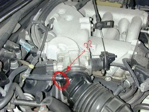

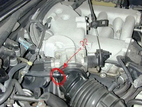

Around the intake area there should be main 1/4" black rubber vacuum lines. Pull one off before you start the engine. Have a buddy rev it up while you use clear airline tubing to suck seafoam out of a cup. Have a pre-measured amount of seafoam in the cup. I recommend 1/2 can. As soon as it is all sucked in, cut off the engine. Wait ten minutes. Take car for a spririted drive. Enjoy the looks on peoples faces. All those haters will be like; "hell yeah, that douche's mustang is finally on the way out, woot!". And they will be so wrong. It will just be stronger afterwards like a phoenix rising from the smoke :nice:
