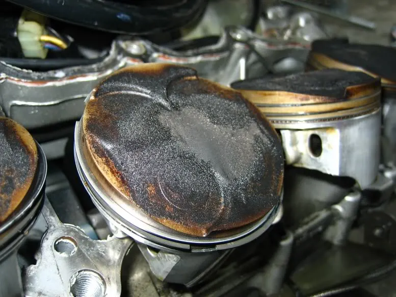

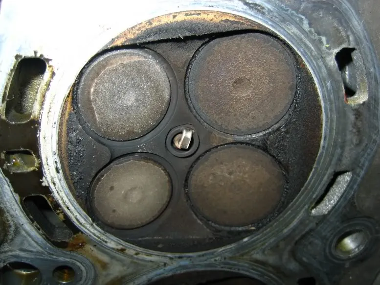

Ran a can in my mustang engine and in my turbo bike engine. The mustang engine was taken apart a couple thousand miles later. The bike engine was taken apart right after. I could tell no difference in cleanliness from any other unseafomed engines I took apart.
As much as I'd like for it to exist, there's no miracle liquid. Without taking the engine apart, the best way to clean the combustion chamber is with methanol/water injection :)
The temporary smooth running effects of seafoam is just from it sealing the rings/lowering your octane rating till it burns off.
