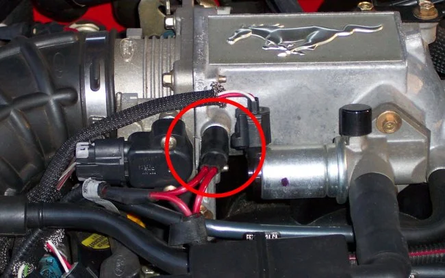

This is from before I had the PI headswap so my engine should look similar to yours. See the piping that I circled pull that off while your car is running. If the car dies then that is the right line to put it on. If the car doenst die then come on here and post again and I will take a different picture and circle the other line it should be.

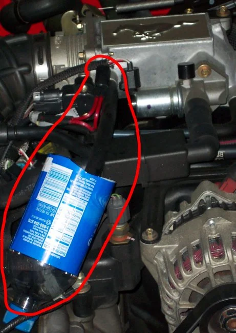

After reading all the fuss about seafoam here, I went out yesterday and bought a bottle. For those of you having a difficult time finding a place to pour this stuff, take a look at your upper intake (plenum). Facing the plenum, there is a hose coming off on the bottom right corner that attaches to all the way over to the passenger side valve cover. Disconnect that hose where the rubber meets the plastic tube (about 2 inches from the plenum, and pour the seafoam in there. With the car on, there is enough vacuum on this line to suck the seafoam right out of the bottle, or do what I did and just pour it in. I'll post a picture if I requeted, but it's very easy so don't be intimidated by this simple task.

Just as I typed this up somebody posts a pic. That exactly the tube I was talking about. :nice:

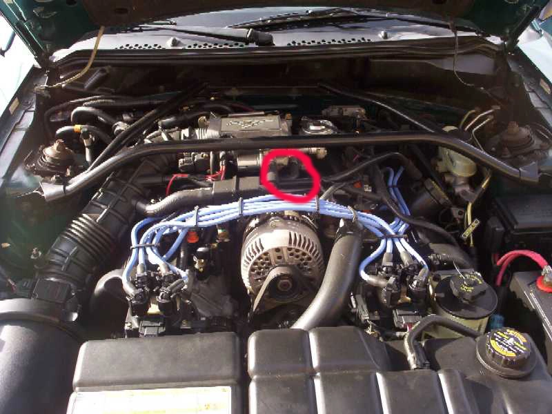

Wikkd explained it well. You have to follow the black tube from the upper plenum to the PCV and you actually pull the end of the tube thats connected to the PCV. Dont pull on the one that Sick96stang circle, just follow that tube until you get to the PCV.

This is the hose I pulled in the first place...but the car died, so I didn't think it was right right hose. Oh well, time to go try again. Thanks a lot!
If it dies right away then you might need someone to give it just enough gas to keep it from stalling. Mine came very close to stalling when I took it off, but it didn't. It did stall a couple of times while it was sucking up the sea foam.
