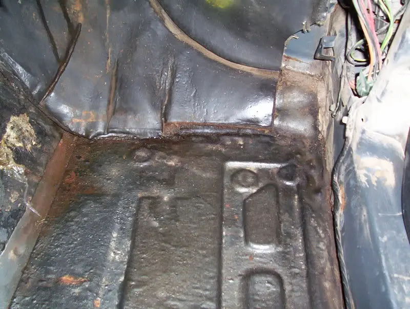

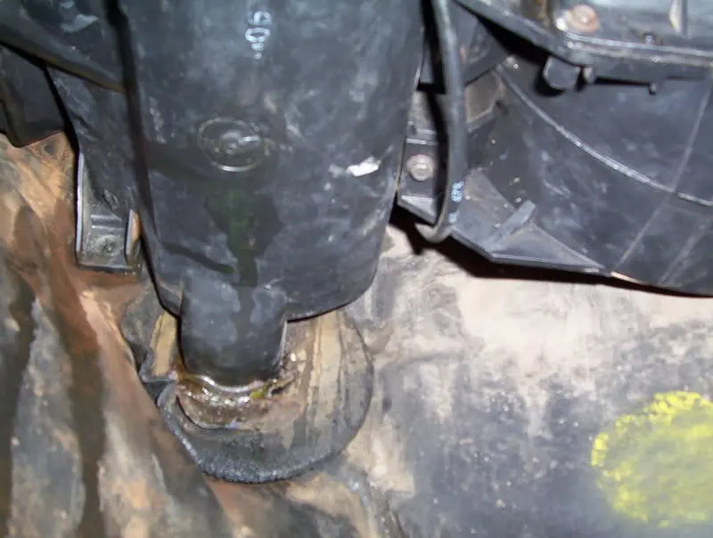

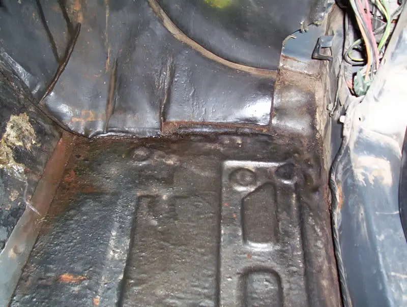

right where that bromet is it leaks. It doesn't leak under normal driving conditions, but when I get on it and go past 4500 rpms it leaks antifreeze. It isn't a liquid it is more like a whiteish-green foam then goes to antifreeze. I just changed out the heater core hoses and the clamps are tight so that can't be the problem. I just got new carpet and dyno mat and cant inst till i fix this.
it has leaked for a while and the PO didn't care to fix it. I am restoring the car and am dooing all the right way. cutting the rusted floor board out this weekend and inst new ones. any help would be great.

Your heater core is leaking it looks like.
As for the floor pans, just take your time and make
sure you grind everything flat and clean.
Sometimes you have to trim the new ones slightly because of
too much overhang between panels.
And spray it all with etching primer AND rustoleum before you
recoat it with floor coating. Rubberized undercoating works for that also.
I just restored my 79 notch.
Good luck man !
Looks like a heater core leak to me. Mine just started leaking this past week and this car is really starting to irritate me.
