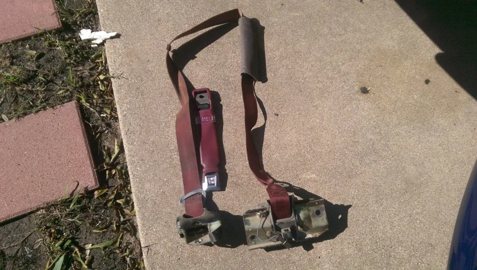

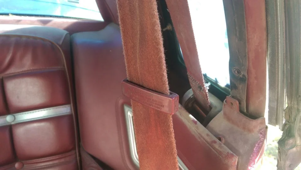

As you can see, my factory belt was frayed and faded, and the retractor by the quarter-window wasn't retracting anymore.

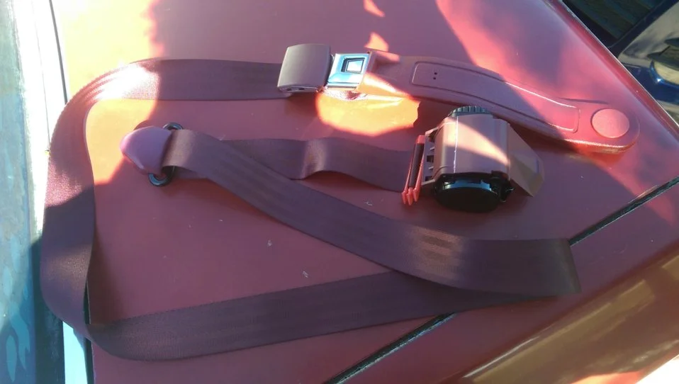

Enter the new belt from Beams. As you can see, it's a great match for the factory color, and the starburst-pattern on the button for the buckle is identical to what was on our cars originally! This belt has 144" of webbing, so you've got plenty of belt, even for a fat boy like myself.

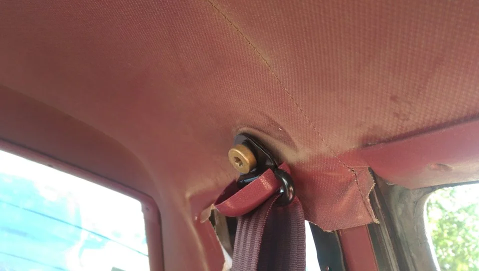

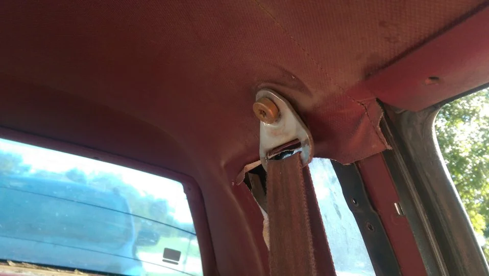

First thing to do will be to remove this cover over the bolt. Mine was so brittle it snapped off in my hand. Next you'd remove the trim around the quarter window to give you access, but I'd already done this to fix something else and haven't yet installed the new piece that's going in it's place.
The original bolt will fit through the hole in the new belt, or the new bolt that comes with the belt fits the hole in the car, the choice is yours, but I wanted to keep everything using the same sized torx socket, so I kept the original. The only downside is that it makes it harder to snap the cover over.

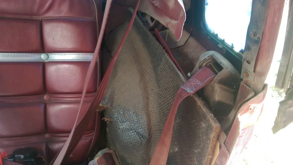

The interior quarter-panel comes out next. You've got two screws in the doorjamb, and one back there by the back glass. After that it pretty much pulls out, but you may have to fight it a bit if your rear seat bottom is still in place. After that, there's one bolt holding the retractor in, it's hidden by the belt and retractor in this picture, but there's a notch in the sheet metal to get an extension and socket into.

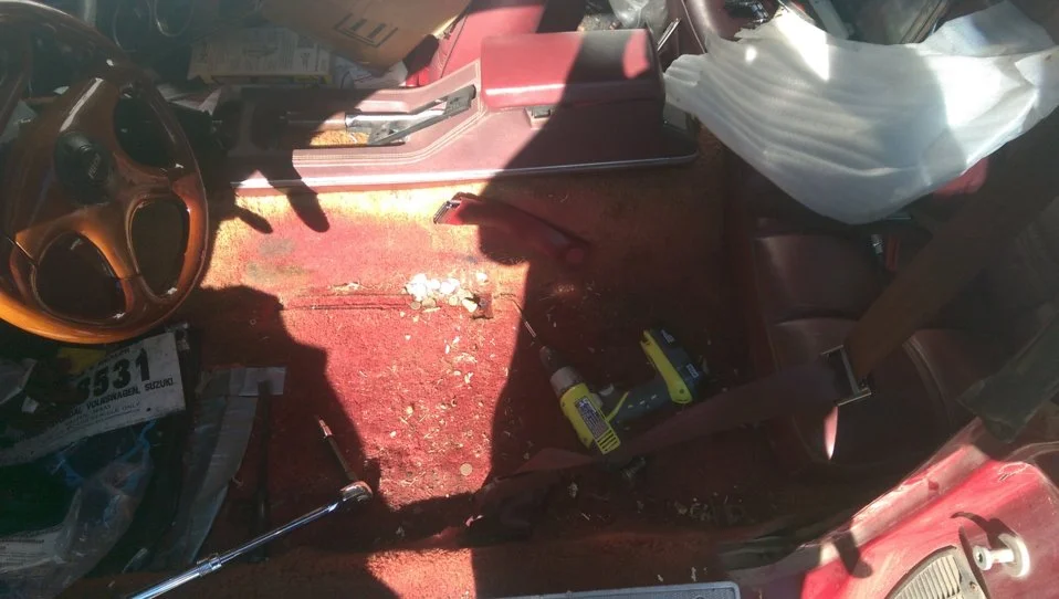

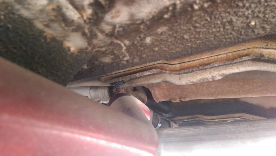

Next, you'll need to get under the car so you can remove the nuts holding the seat(s) in. There are four nuts on each seat, and you'll need a 1/2" deep socket to take them off. My car has this brace that was installed by the previous owner that forced me to use a wrench on one of the bolts on each side... Friggin previous owners!

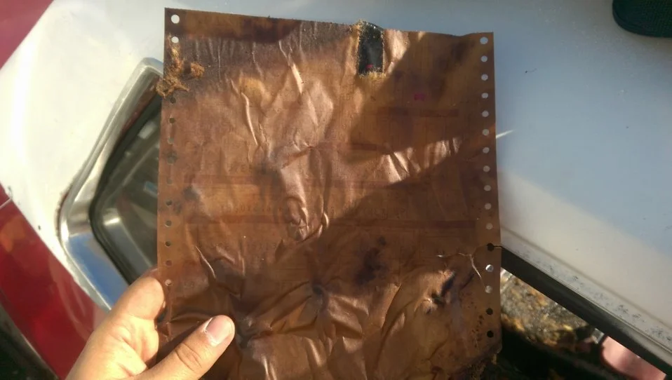

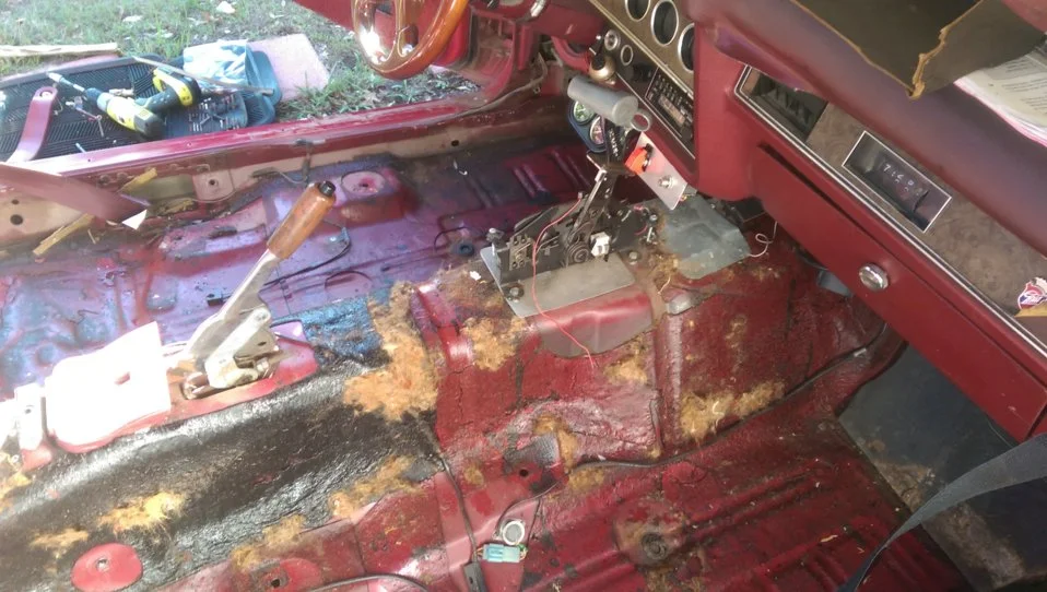

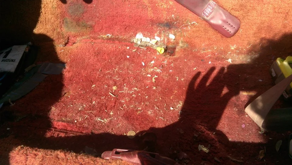

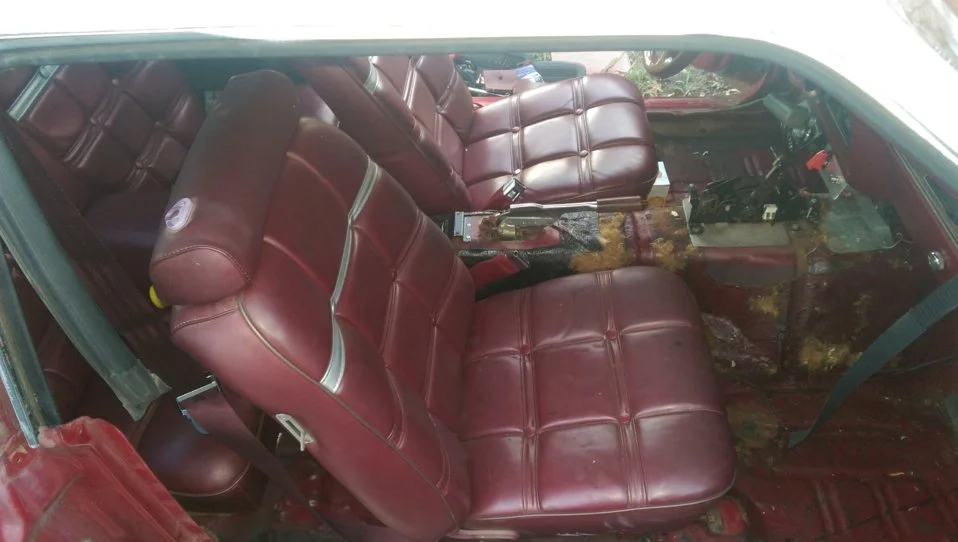

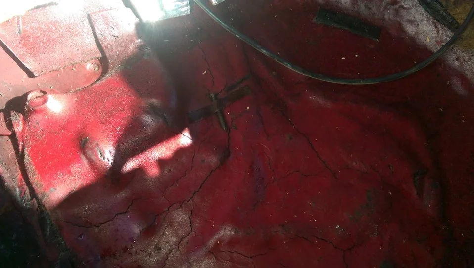

Upon getting my seat out on the driver's side, I realized I had a full-blown crisis on my hands. That's mold, growing in the carpet. I decided to finish the seat belt install to be able to finish this thread, but that immediately after I'd be ripping the carpet out. (The mold is due to weatherstripping that I didn't put back in after doing body work three weeks ago letting in water when we got about 2 feet of rain over the past two weeks, I knew the carpet was still damp, but didn't realize I had something going this wrong until yesterday.)

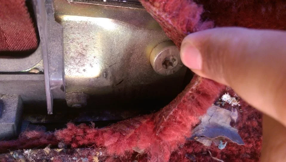

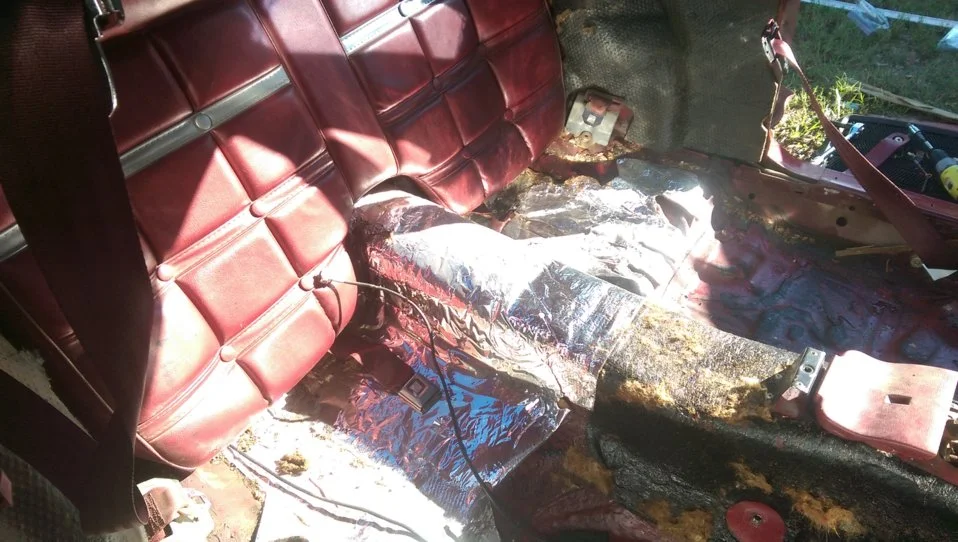

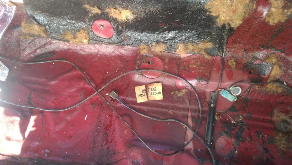

If you pull back the carpet around the retractors (do it carefully if you're not replacing your carpet, your 37-41 year old carpet is going to be brittle!), you'll see two more torx bolts holding it in.

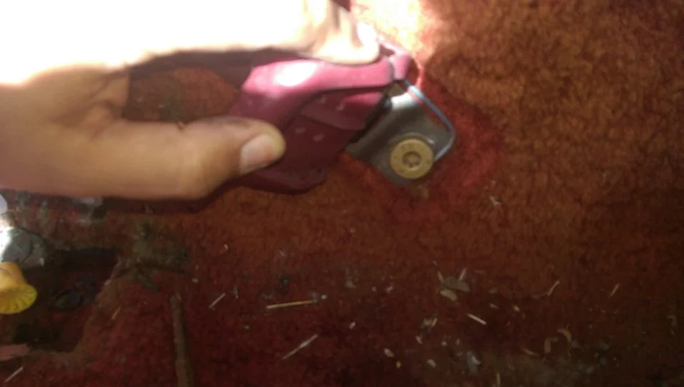

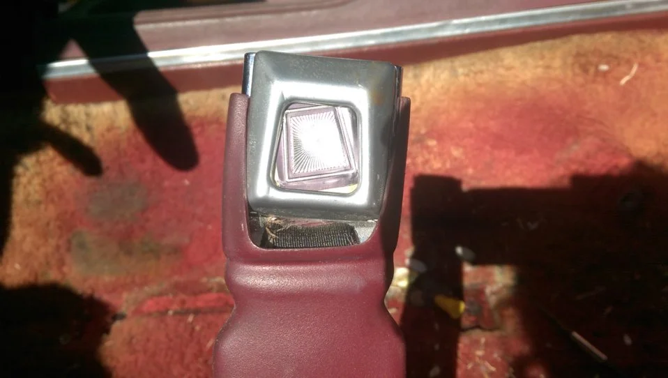

The buckle has one bolt holding it in.
The new buckle looks natural in it's new habitat. I didn't take a good picture of it, but on the lower belt anchor, I used the rear hole with the belt aimed forward and at an angle for now. When I put new carpet in, I will probably be relocating both to the forward holes to facilitate mounting the original covers (which previously bolted to the lower retractors, I'll be fabricating a bracket to use them).
