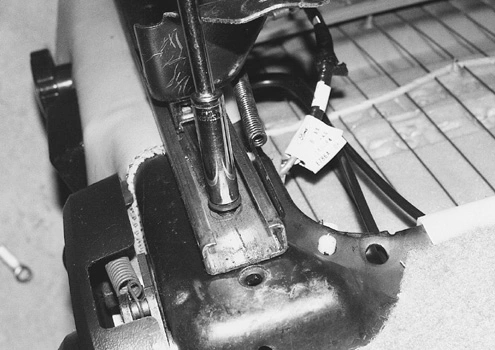

see picture for reference, it doesn't appear to have a bolt in this location, just somthing that is rounded and appears to be pushed through the metal or maybe pressed,lol how come i dont have bolts in this location
edit: nvm this photo is taken from underneath the seat huh?

I seem to recall one bolt hole (the front left one, on the passenger seat) being a stud. Only a nut comes off that one. Then you have to lift the seat over the stud (you should kinda lift the seat straight up so you dont gall the threads). A small prybar under the seat track (where it meets the floor) will help break it loose if it's rusted to the floor.
