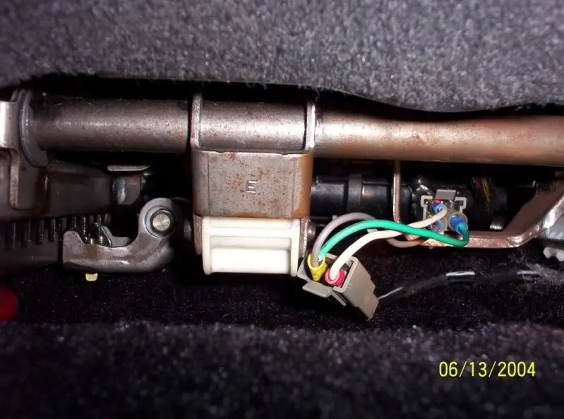

I have 03 cobra's in mine and love them. I just clipped the factory plug on mine and hooked up the power wire (from my car) to the 2 Green wires on the 03, then hooked up the black ground wires. That was all that was needed to get full power.
Here is a picture that I found online

Brilliant! Thanks for the photo.

Here the picture again for some reason I can no longer edit my last post
