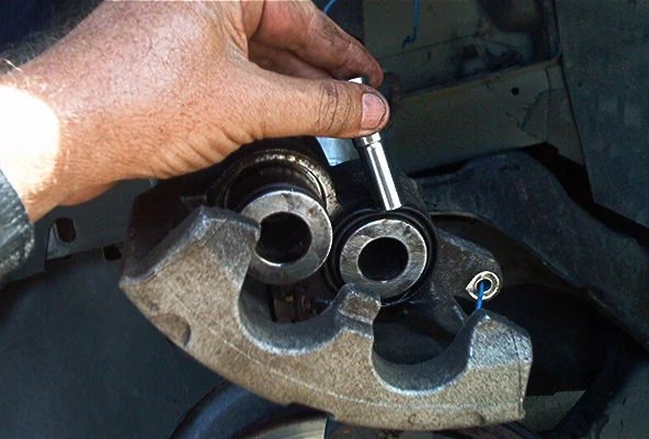

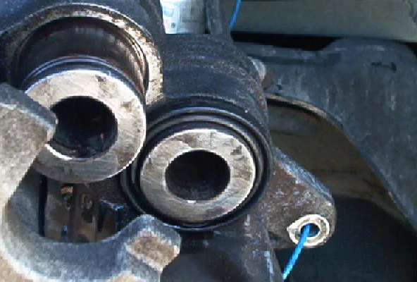

OK, here's the situation :
Removed caliper, and had assistant pump brake pedal. One of the caliper pistons eased on out , slowly. The other remained stuck ! I re-inserted the piston which came out into the bore and used my trusty disk pad spreader to try and force the balky piston out. No dice. I have to admit defeat at this point , and I ordered a new caliper from NAPA.
A couple of surprises :
The aluminum caliper on my 99 GT is made by "PBR", I guess they are the prime vendor for brake parts for Mustangs of 1999, at least.
The pistons are NOT steel, they are some kind of phenolic resin design. I guess this design is OK, as the resin will never rust. Beware compressing this type of piston when doing a pad change, obviously.
I have attached some pics ; hopefully it will help some other Stangnet member in the future !

PBR is a brake supplier based in Australia. They supply brake calipers for dozens of OEM calipers. They make the Cobra calipers, Corvette calipers and a ton of GM and Ford truck calipers..as well as other applications
The rear calipers are made by Varga, which is based in Brazil.
