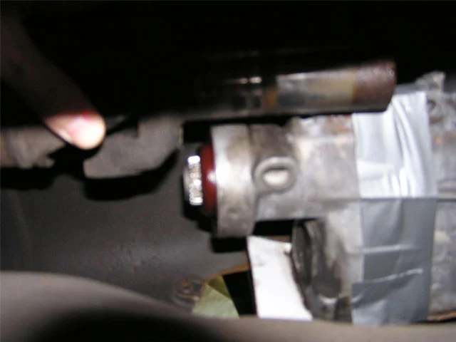

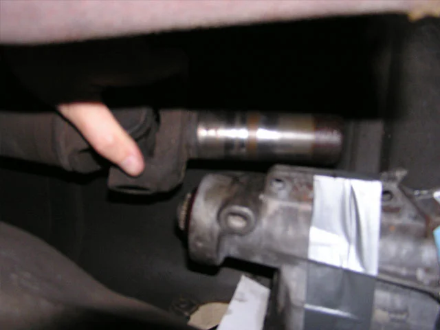

OK Guys,
I have engine in with T-5 tranny and late model bellhousing.
Here is how the driveshaft is lining up. If I have to shorten and
re-balance, How much should I go? 1/2", 1"? I don't know.
Or is she good to go?
see pics
thanks
andy

NOT good to go,needs shortening.Remove the shaft from the rear,install it in the trans,(with a little bit of play) scribe or mark the yoke were it sits best. take it out.reinstall on the rear,then look at the same view you posted again and you will see it.

In any case, it's obvious from the pics that Andy's driveshaft needs to be shorter by about a half inch to an inch. COBRAIIW's method will tell for sure how much to shorten.
