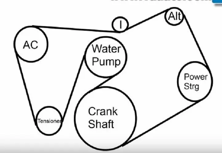

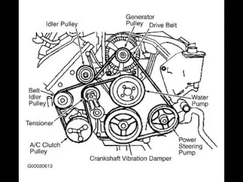

As for the crank bolt. Its going to be the bolt holding the largest pulley on on the front of the motor. It will be at the bottom of the motor as in if you are standing in front of the car looking down it will be in the middle and the pulley closest to the ground. Should be pretty hard to miss. Here is a diagram of a V6.
And one for the V8.

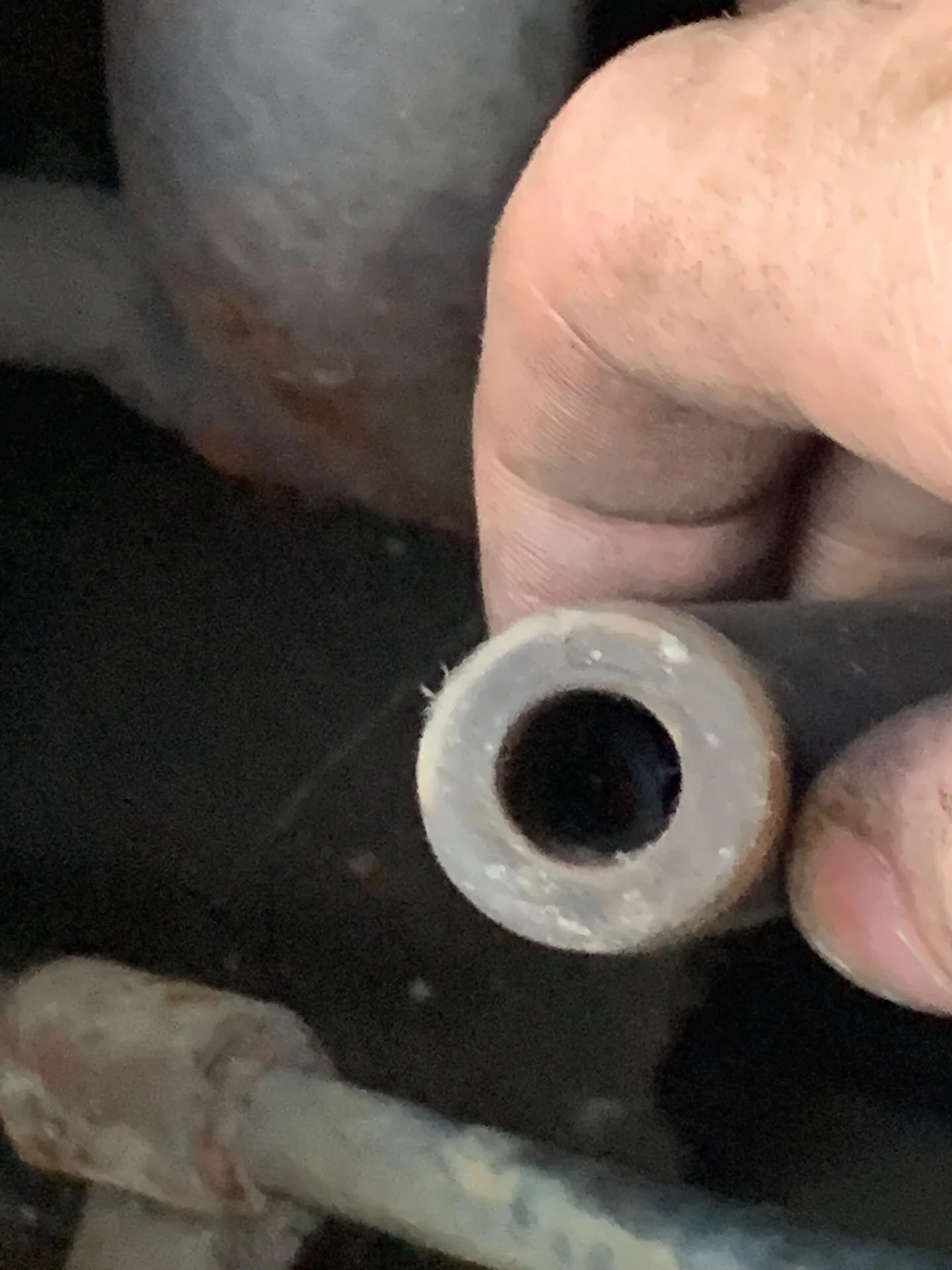

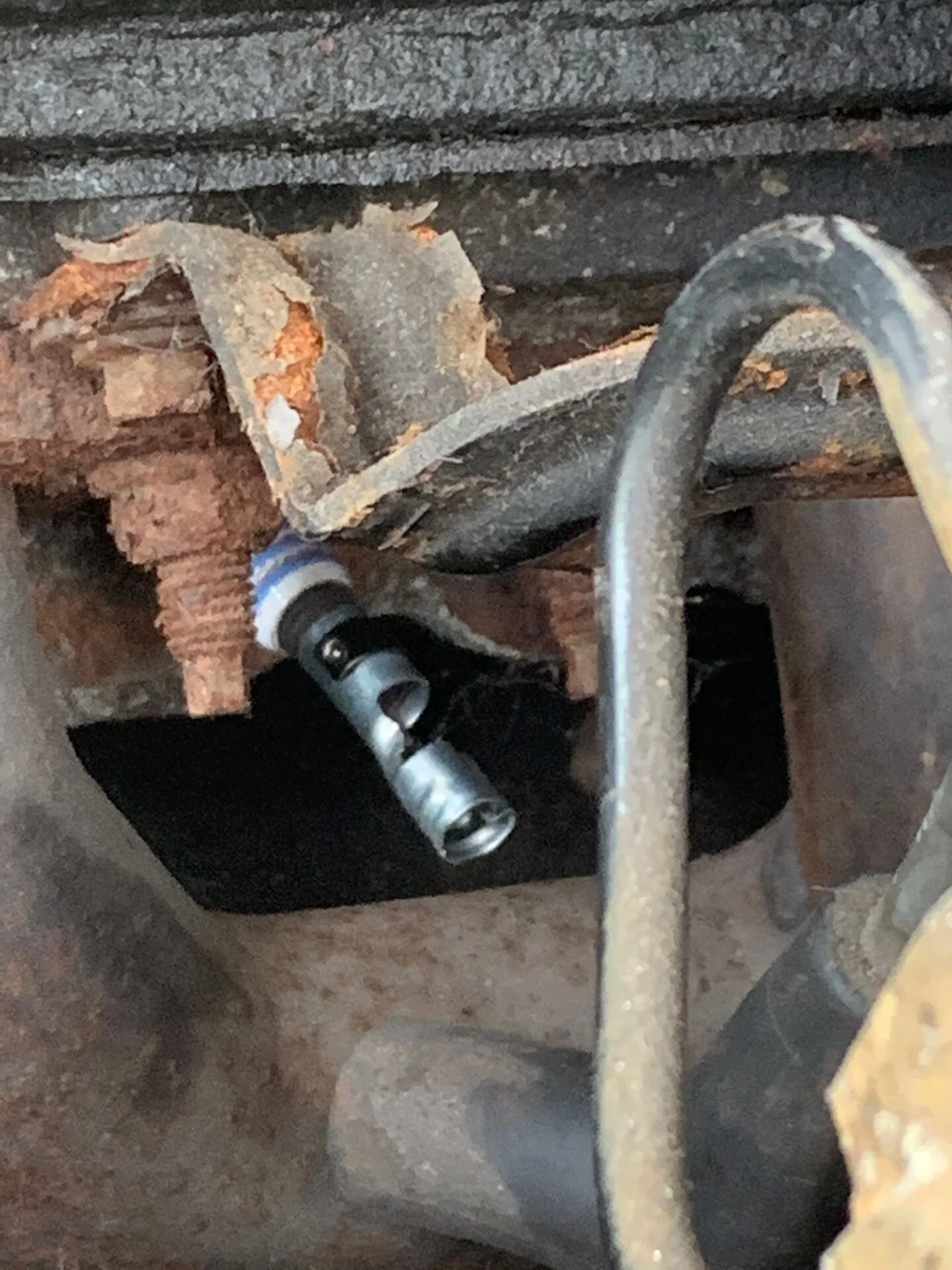

1. After pulling the covers on the spark plugs 2 of them came out with the metal from the inside of the tube still stuck on top of the spark plug. any way to salvage this? Photos attached.
2. All the spark plugs are a pain to get to. How do i now get marvel mystery oil down into those spark plugs efficiently. Any suggestions?

Those coils can be pushed back up in the black spark plug housing. Happens all the time so no issues reusing them.
Thanks Onesick99GT I wil give that a shot once I get new plugs.

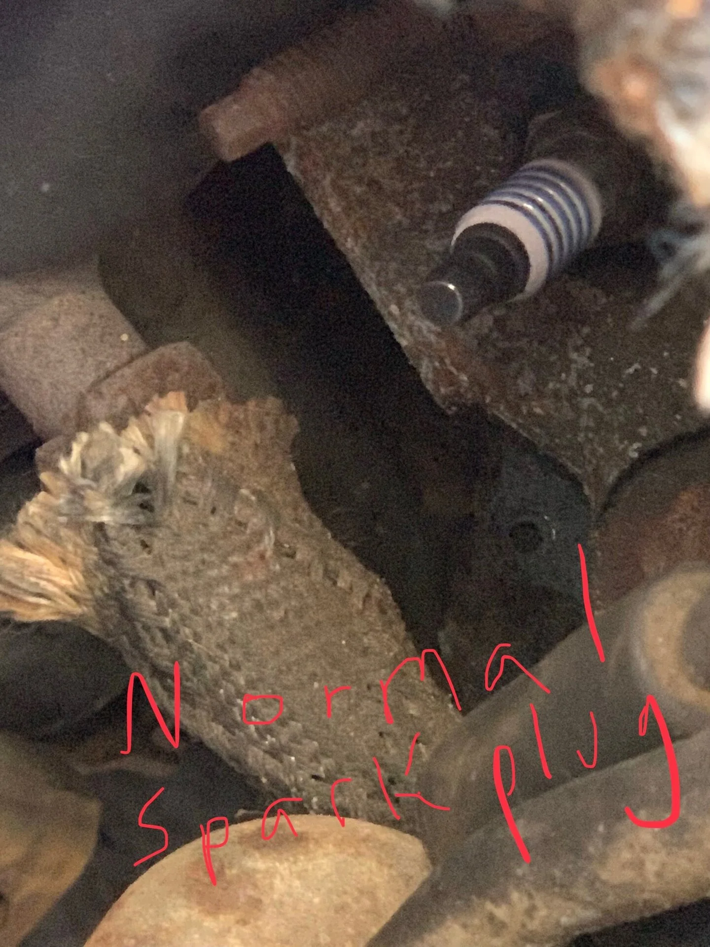

Now- I have 2 more questions. I couldnt figure out from google.
1. 80% Sure I should be turning the crank by hand clockwise. To the right basically. Correct?

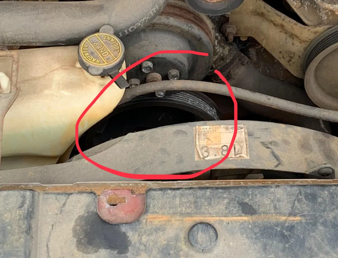

2. I THINK I got the crankshaft nut moving a bit after using a breaker bar. now the spindle thing where the belt would go. If you imagine where the bolt is in the middle - that ring on the outside....
When I turn the crankshaft bolt I dont see anything else moving. Is this a problem? I figured turning the bolt would make it move so I might be completely mistaken.
Now I had wiggled it a little to the left - counter clockwise... When I did that it almost felt like the nut was getting very loose. Is that ok?
Im very sorry if these questions are dumb. Even google couldnt save me haha.
