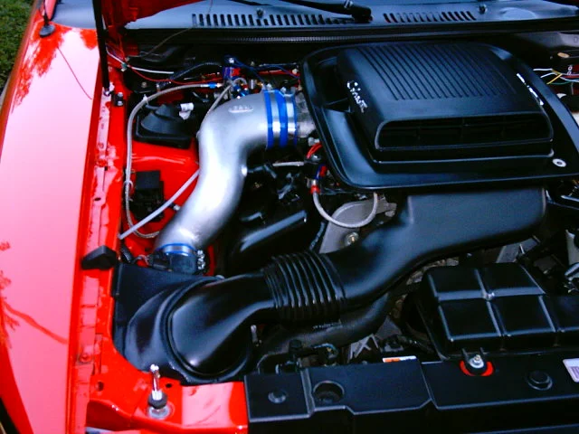

:stupid: I was one of the first to go with the complete C&L Mach 1 package, air box to throttle body, last August. I haven't had one problem with this setup and I'm running a 75 shot of nitrous through it. I think some people just have no clue what the hell they're doing, and screw the install up, although it really isn't rocket science.

My experience with it exactly. I can't see from your pic, but do you also have the C&L 85mm MAF housing?
