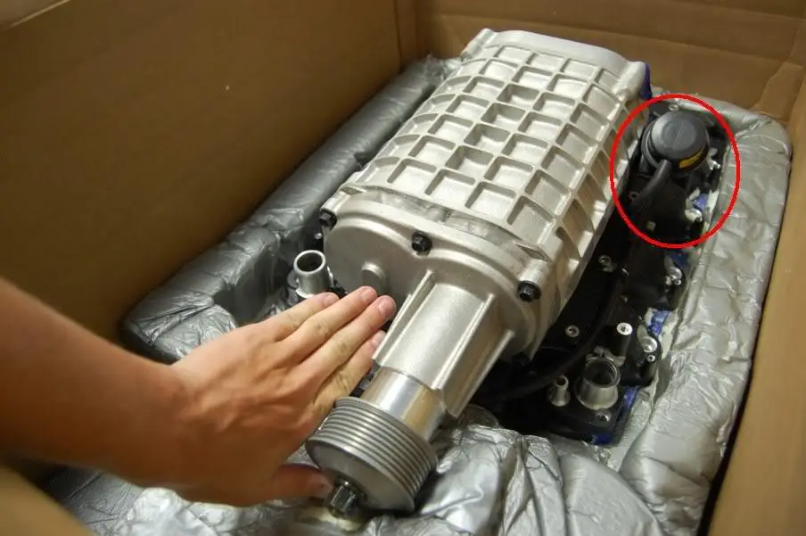

I hate to tell you, but that’s incorrect. You'll get the same mileage with the Kenne Bell as you would with the Centrifugal, or you would stock. You're not "boosting" on the freeway with the Kenne Bell (or any modern Positive Displacement supercharger for that matter) because you've got a bypass valve thats set to stay open under vacuum that only closes to pressurize the intake when you put your foot into it. The blower is free wheeling under vacuum and takes only about 1/3 of 1hp to spin.

I did not know that. I didn't think they could fit a bypass valve in there. :nice: You learn something new everyday.
Yup, it's a wonderful thing; here's mine.
On a 03 cobra it's on the underside - a semi circle butterfly valve.
