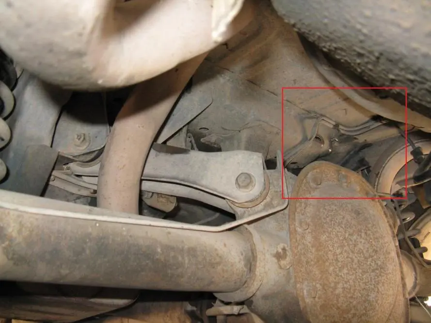

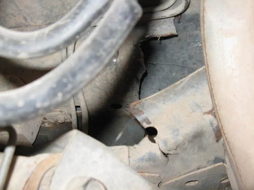

ok........My right upper torque box has been completely torn out of place, how bad is this going to be to fix? I was thinking of dropping the rear end out so I could replace the shocks and control arm bushings then do I just mock it up and get it welded back into place? I should probably buy some battle boxes to add to it too, huh?

Yep, decoded the vin last night. Someone put some serious time into swapping everything over. Cause as you can see it's got the 8.8 in it too. How dangerous is it to be driving with that thing like it is? I need to get it to my g/fs dads house so I can put it up on stands and drop the rear end out of her
There are other options depending on how much you have to spend. Go check of the Maximum motorsports page and check out the torque arm and panhard bar. If you install both of these you can remove the upper control arms.

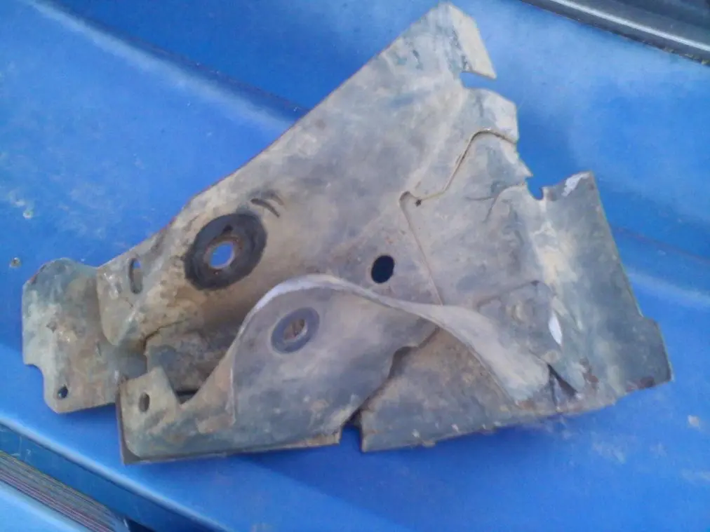

Jacked up the car today, dropped the gas tank, pulled off the right side exhaust and unbolted the UCA out of the broken off box. Got most of it hammered into place, tomorrow the welding begins
