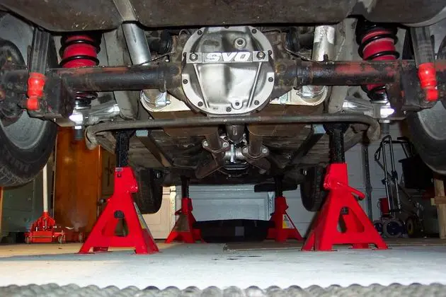

lol,hey you have my setup what suspension mods you runnin to get into 12's thats my goal

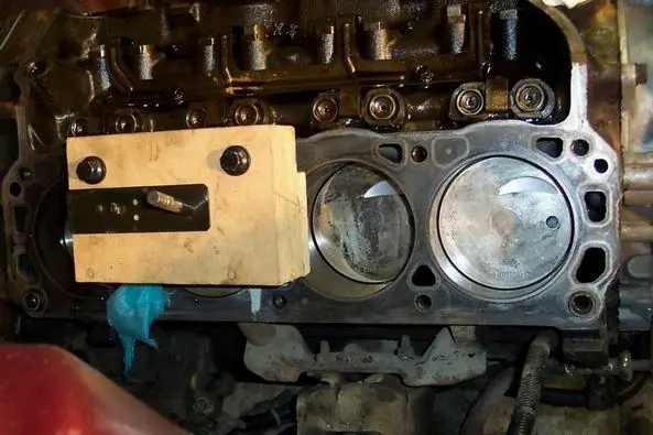

86gtstang- what pistons are you running? just curious

I run Steeda Alu. upper and adj billet lower control arms, dual airbags, FMS lowering coilsprings,koni rear shocks,Monroe front struts,STEEDA dragrace swaybar, welded torkboxes, and subframes. G60-15 (254/60-15) Racemaster DOT slicks.
No dragracesuspension, except adjusting the airbags because of bodyroll.

Im running my stock ones. Had them flycutted, home alone ,homemade flycutting tool...An oversiced chevy valve,2.07",glued on some grinding paper and a batteri drill. Clearance was tight without flycutting, only 0.75mm P/W clearance. If you can , just install new ones.
