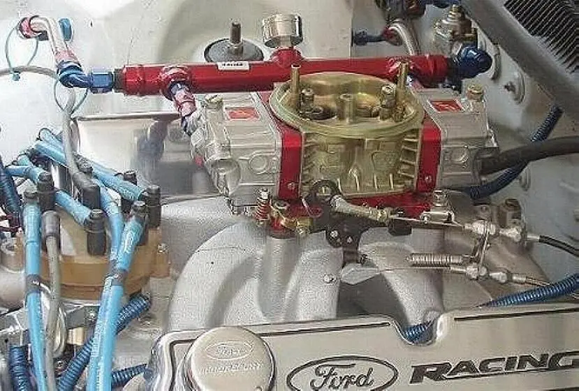

Here is my Lokar bracket.
This is how I modified mt gas pedal to secure the other end.

When I had a normal AOD, I made sure the throttle was adjusted correctly, then marked the max TV position on the trans. With the car off, I then hooked a wire from the carb linkage to near the P/S, so it had the carb at WOT. I then adjusted the TV cable till it only had about 1/8 inch before the TV cable was at max on the trans. This worked out very well for spirited driving, and the transmission had 190,000 miles on it when I decided to put a Lentech in the car. Use the small stop on the end of the cable to make your rough adjustment, then the nuts on each side of the mounting bracket to do the fine adjustment.
Adjusting the TV cable with a pressure gauge with a Lokar cable will not give you enough pressure at WOT.
