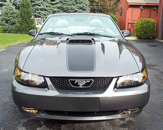

Take it from someone who knows from personal experience, DO NOT install a CDC Shaker Hood kit on your car! I got an '02 GT that the dealership had that kit installed on. A year and a half later I am doing 70 MPH down the interstate and the applique (the black cover that is bolted on top of the hood and surrounds the shaker scoop) started coming off! I check it out and 3 of the 4 bolts that held it to the hood were missing! I took it back to the dealership and they "repaired" it. I kept checking the bolts and there were signs that it was going to do it again. I traded that car in and got my Mach 1.
BTW, CDC says that the shaker kit adds 5% horsepower. If your 2001 Mustang has 260 HP it will raise it to 273. There are a lot cheaper, and safer, ways to get that gain. If you are wanting it for looks, buy an actual Mach 1 and save yourself a lot of headaches.
My old '02 GT with the CDC Shaker Kit:
