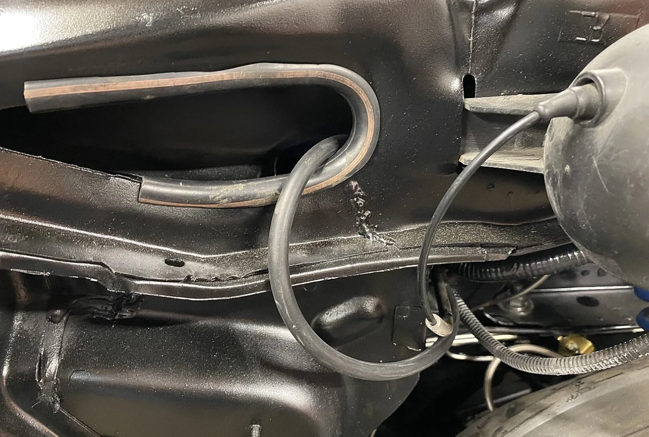

I only partially shaved my engine bay and did a partial wire tuck. I am pretty sure i had the cable come out of the iriginal hole and then immediately routed it into the fender, but I will need to check. From there i ran it along the outside of the upper rail. You can kinda see it in this pic. I'll have to go doube check what hole it came through the firewall. I still have cruise so I doubt i used that hole for the cable.

Exactly this . Something is off with his routing . I’ve done 2-3 like that and no issue

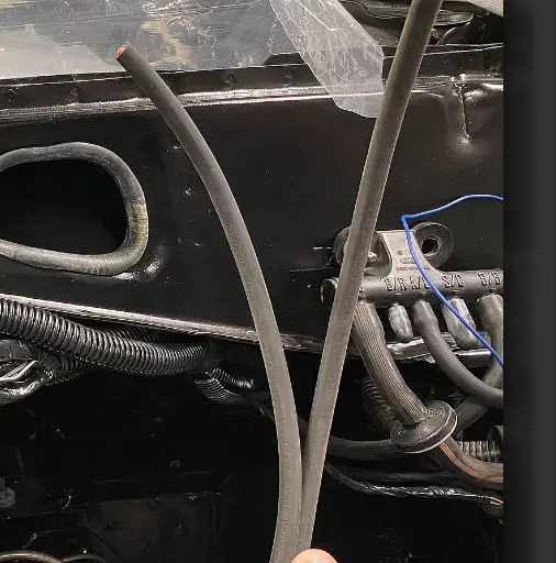

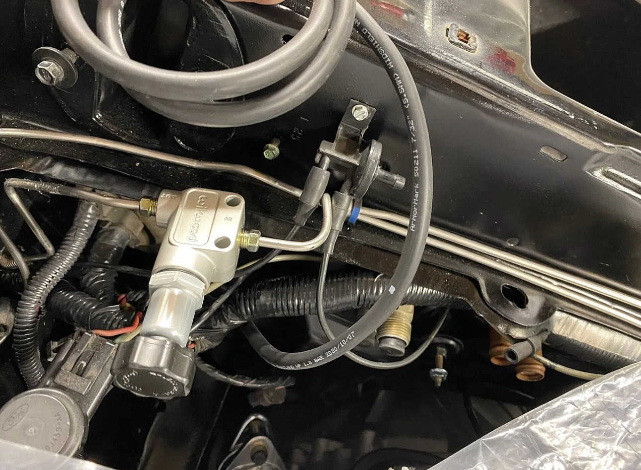

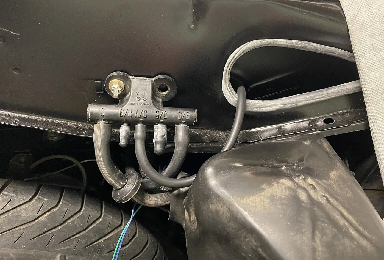

@Mustang5L5 do you have more pics of how you routed your vacuum lines?
I searched for a good 10 mins but don't have any good pics unfortunately.
All i have is a sorta-pic showing it here. Essentially the main line from the intake connects to Source (on the left) and comes in from a hole on the rear of the strut tower. I have hydroboost so I don't need to feed the brake booster. My cruise just gets a small jumper to the module, but I run the AC line through the cowl.
The line with the red arrow goes through the cowl over to the other side where I feed the HVAC stuff behind the strut tower.
I looked for better pics but guess i didn't take any. Everything under the fenders now

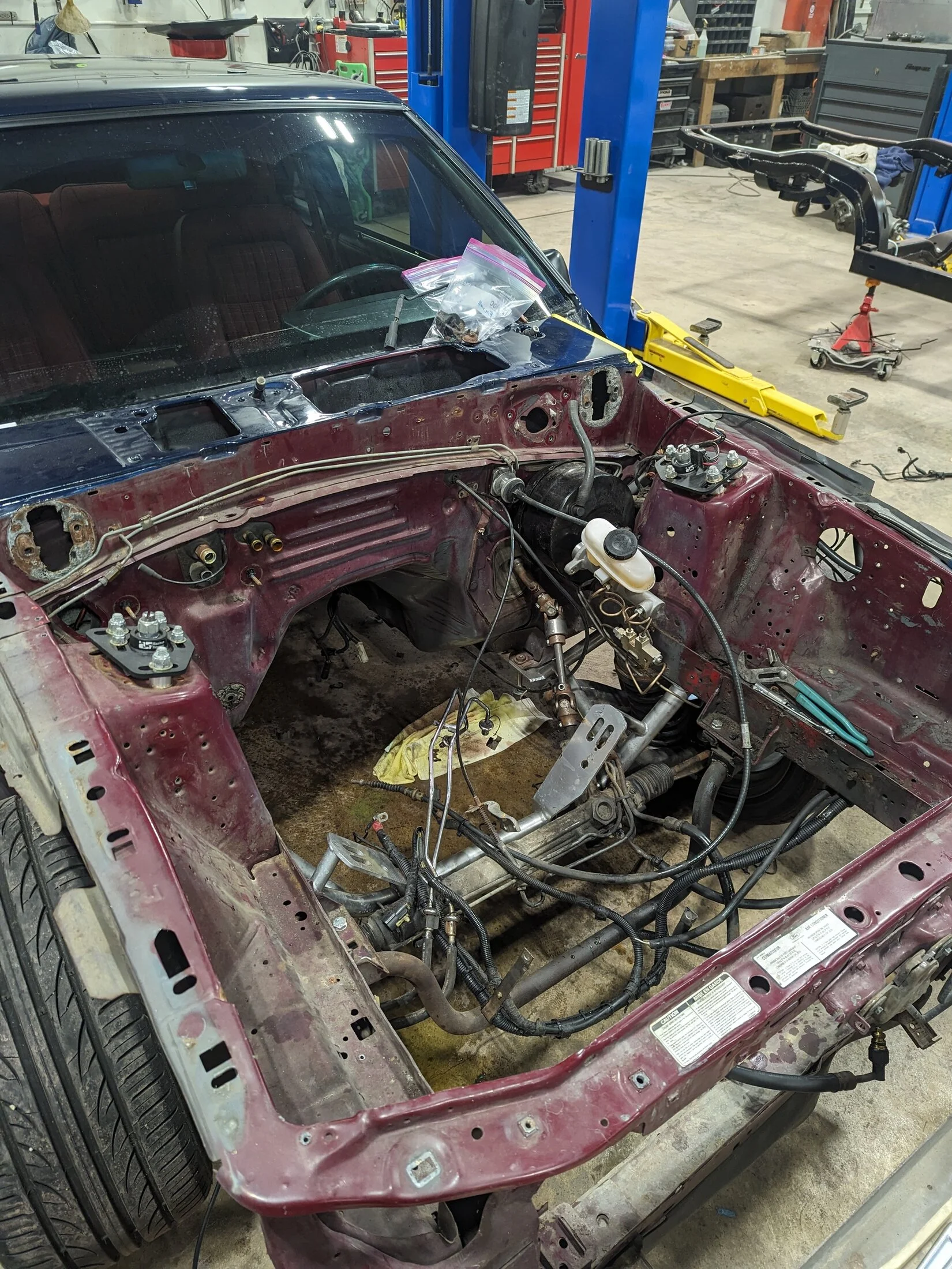

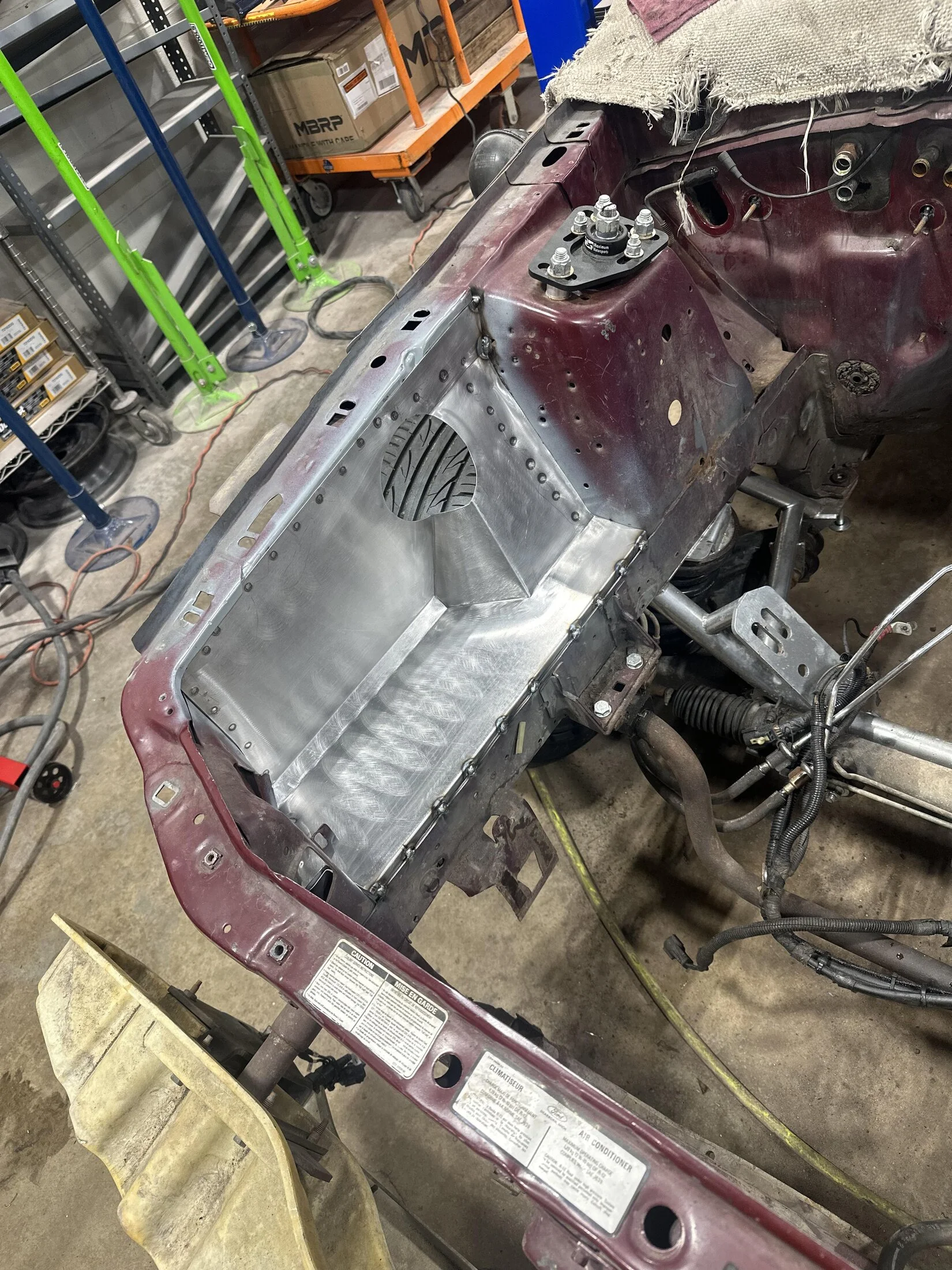

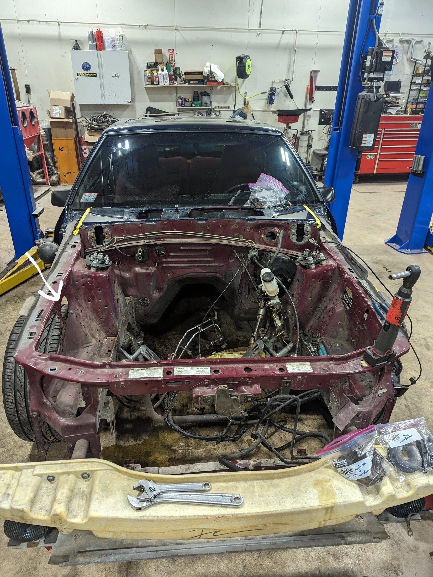

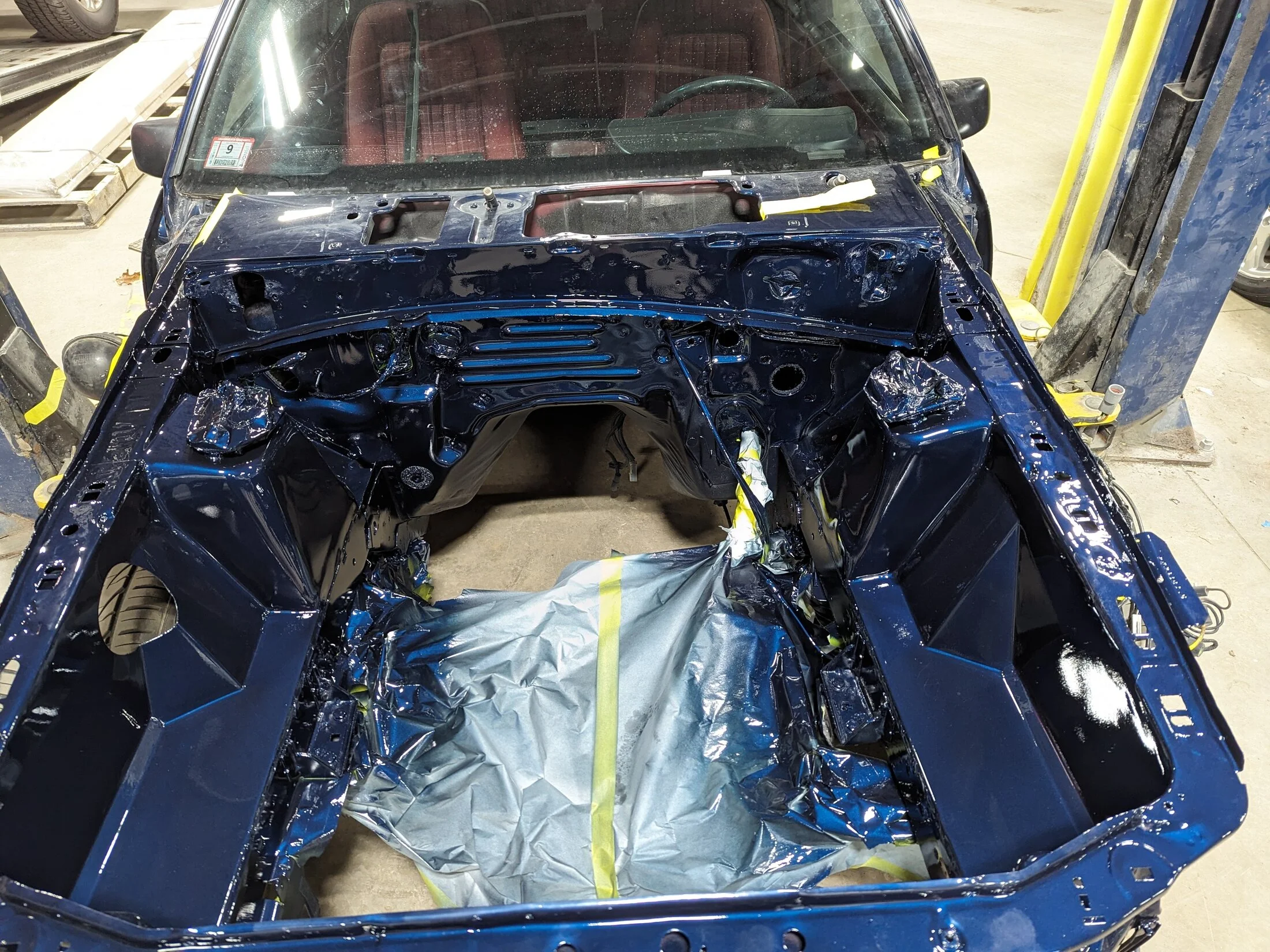

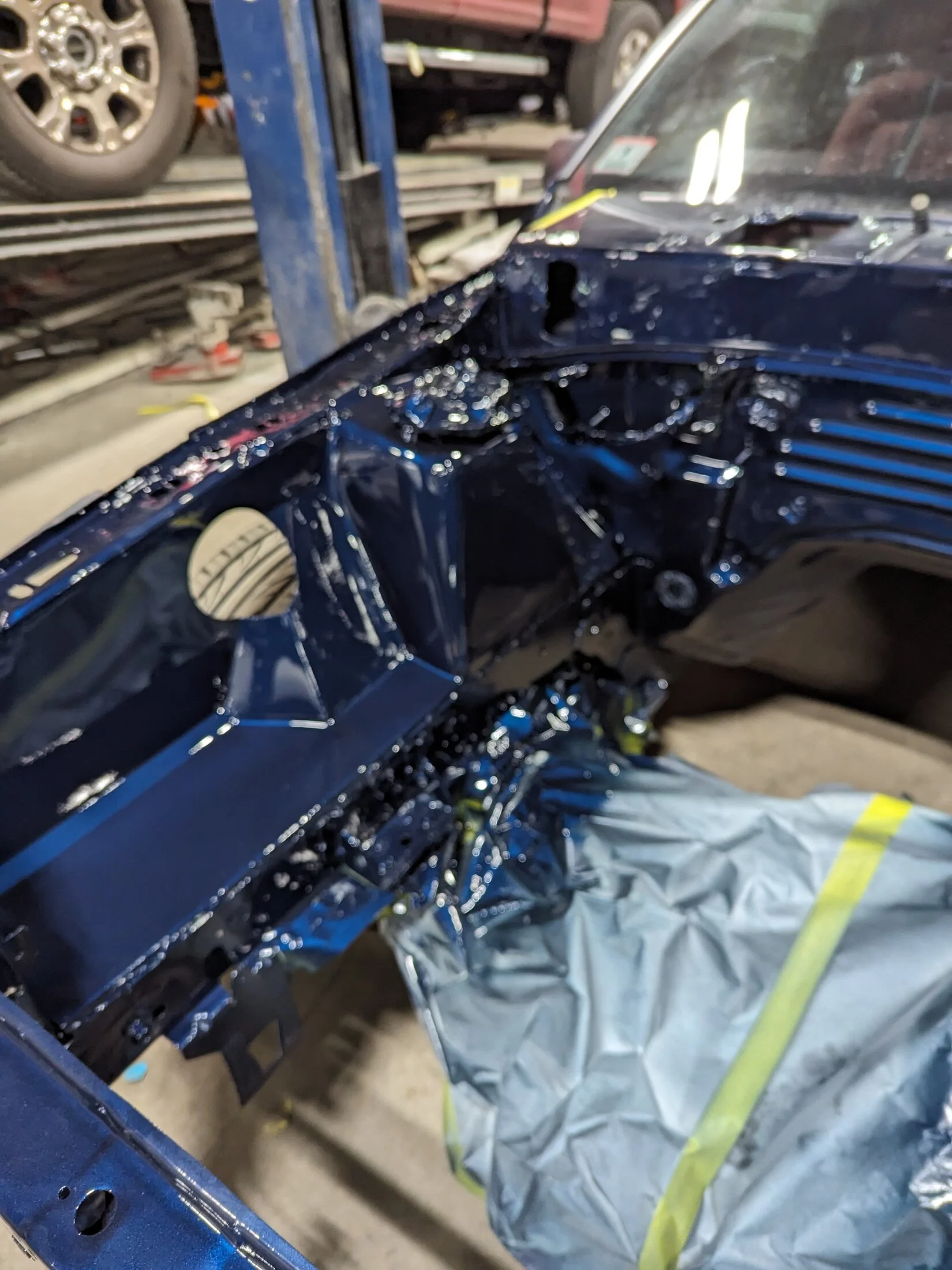

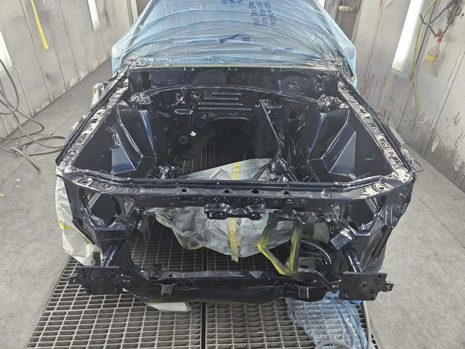

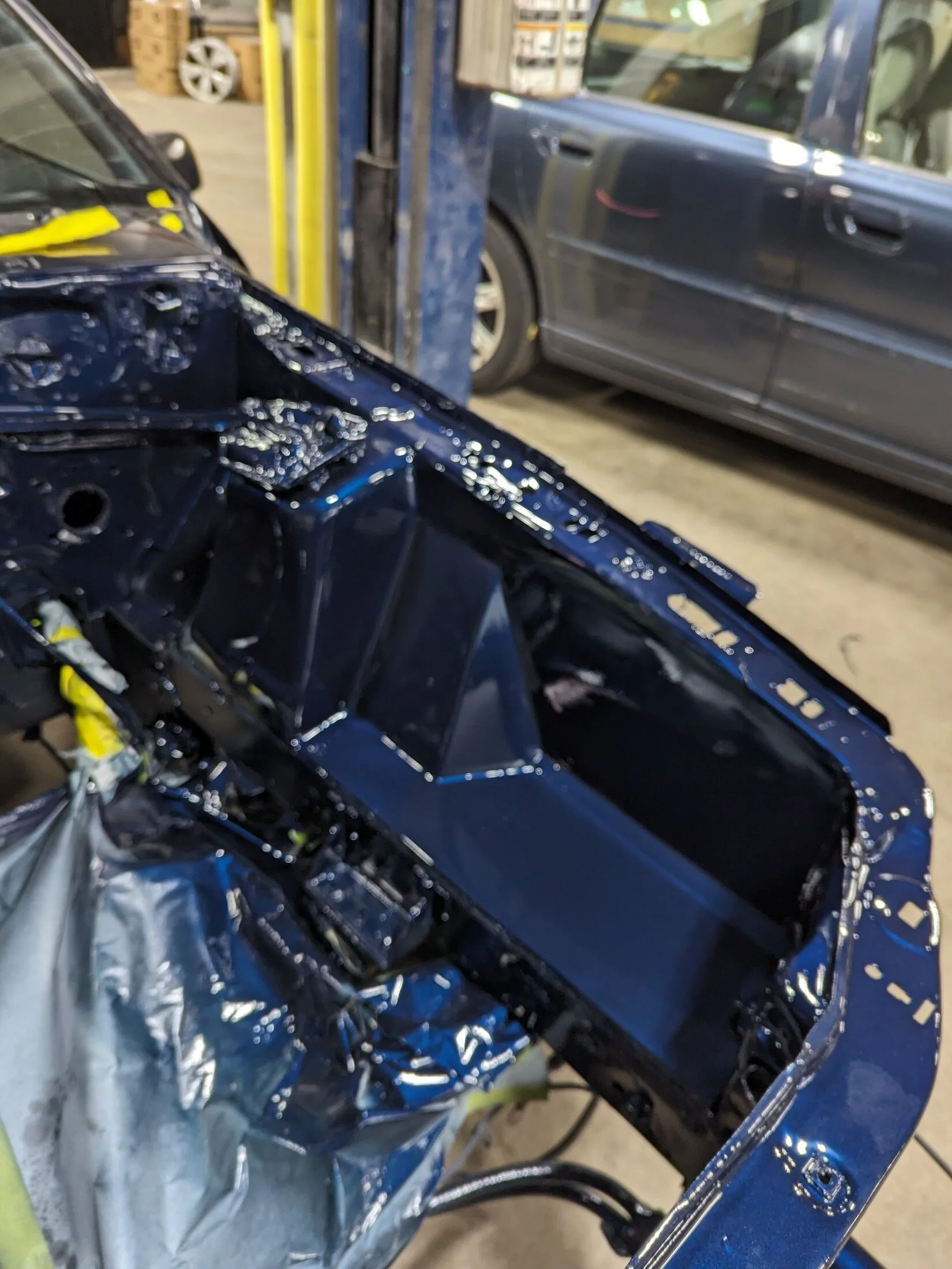

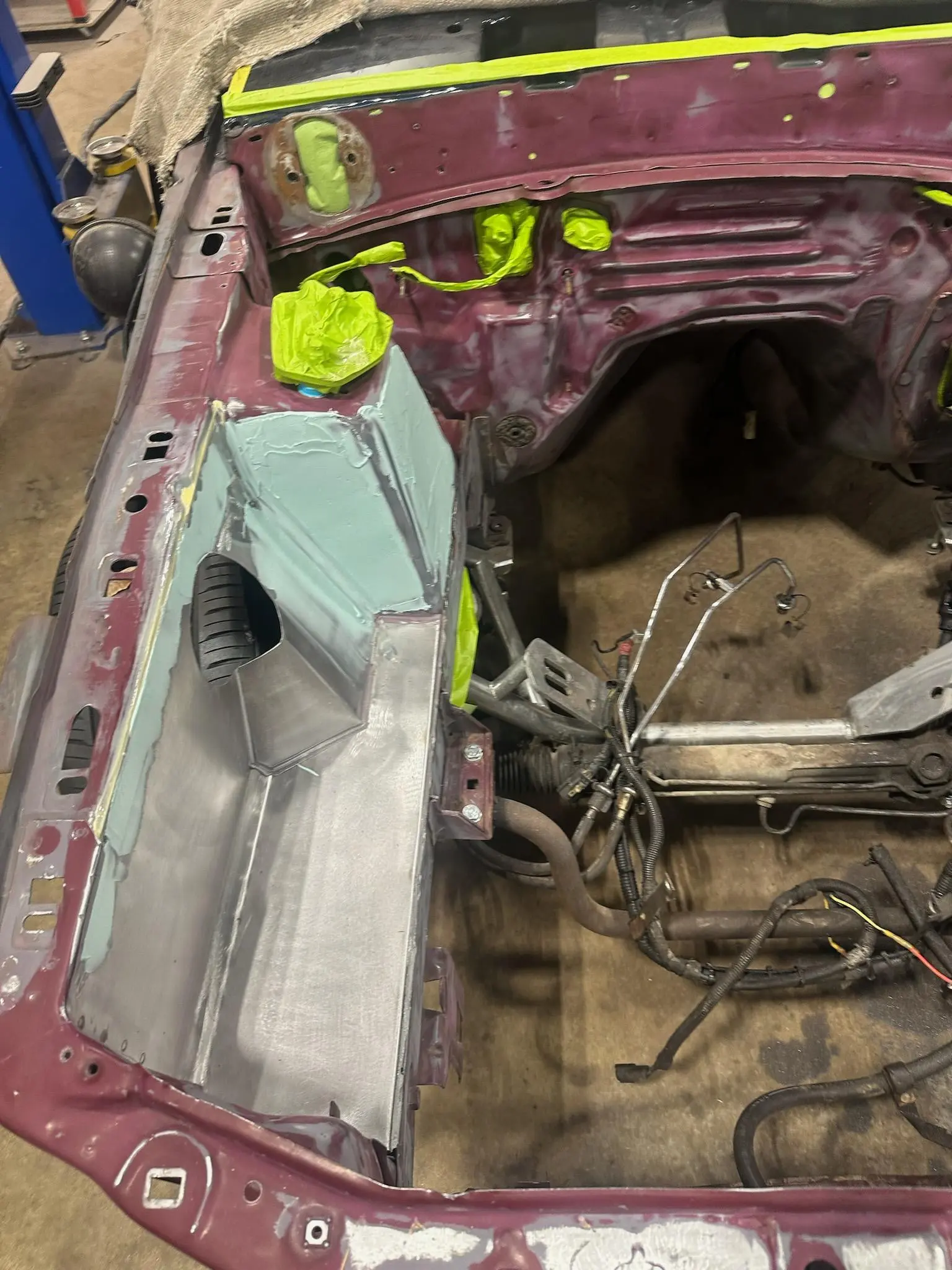

Bay is painted, didn't go full crazy will filling holes but it's definitely way nicer now. Figured I'd throw some pics here rather than start a new thread.
Assembly coming soon
