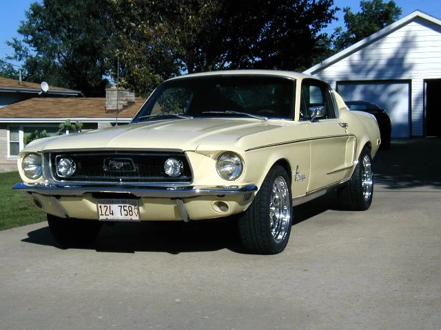

Just finished the complete suspension, Granada disc brake swap, and shelby drop on my '68 fastback yesterday. The car is back on its wheels, but I still have to plumb in the master cylinder and prop. valve. I asked the same question on here when I started the project, and after listening to the replies, decided to do the shelby drop also. The car sits exactly as I wanted it to after all the work, and I figured doing the shelby drop can only help the handling. Also, since it adds negative camber when the suspension compresses, it gives me more tire clearance when turning too.

Sorry to go off-topic. But, red302, what size and brand of wheels and tires are those? They look good.

I am sorry too but do you have more pictures of your car!!? I like it!
Thanks guys!
They're Billet Specialties Fastlane wheels. Fronts are 17" x 7" whith 225-45-17 tires, and the rears are 17" x 8" with 255-45-17's.
1965stangcoupe.....I'll post a couple more pics when I get home later this evening.

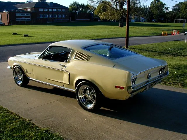

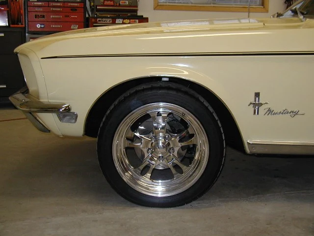

Thanks man, here's a couple.
