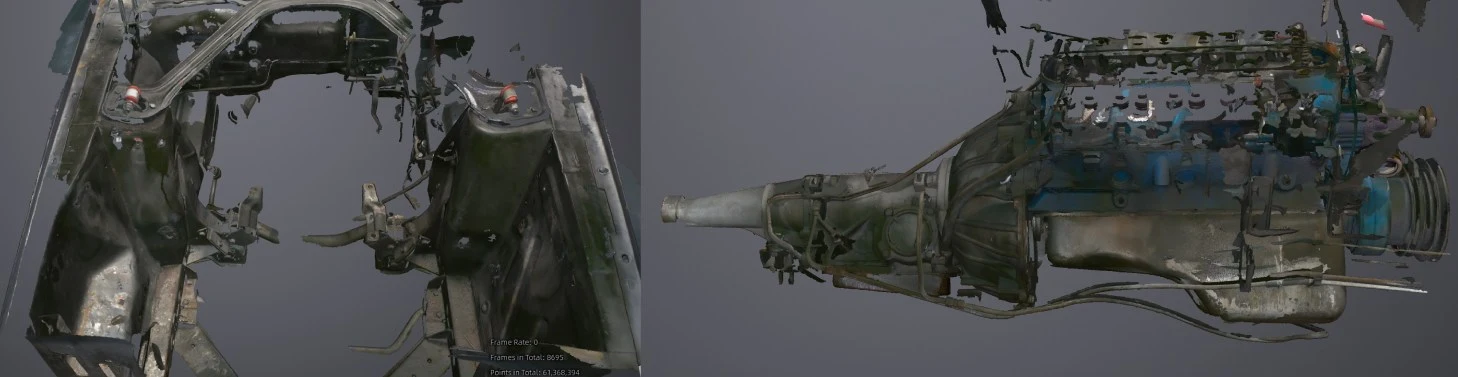

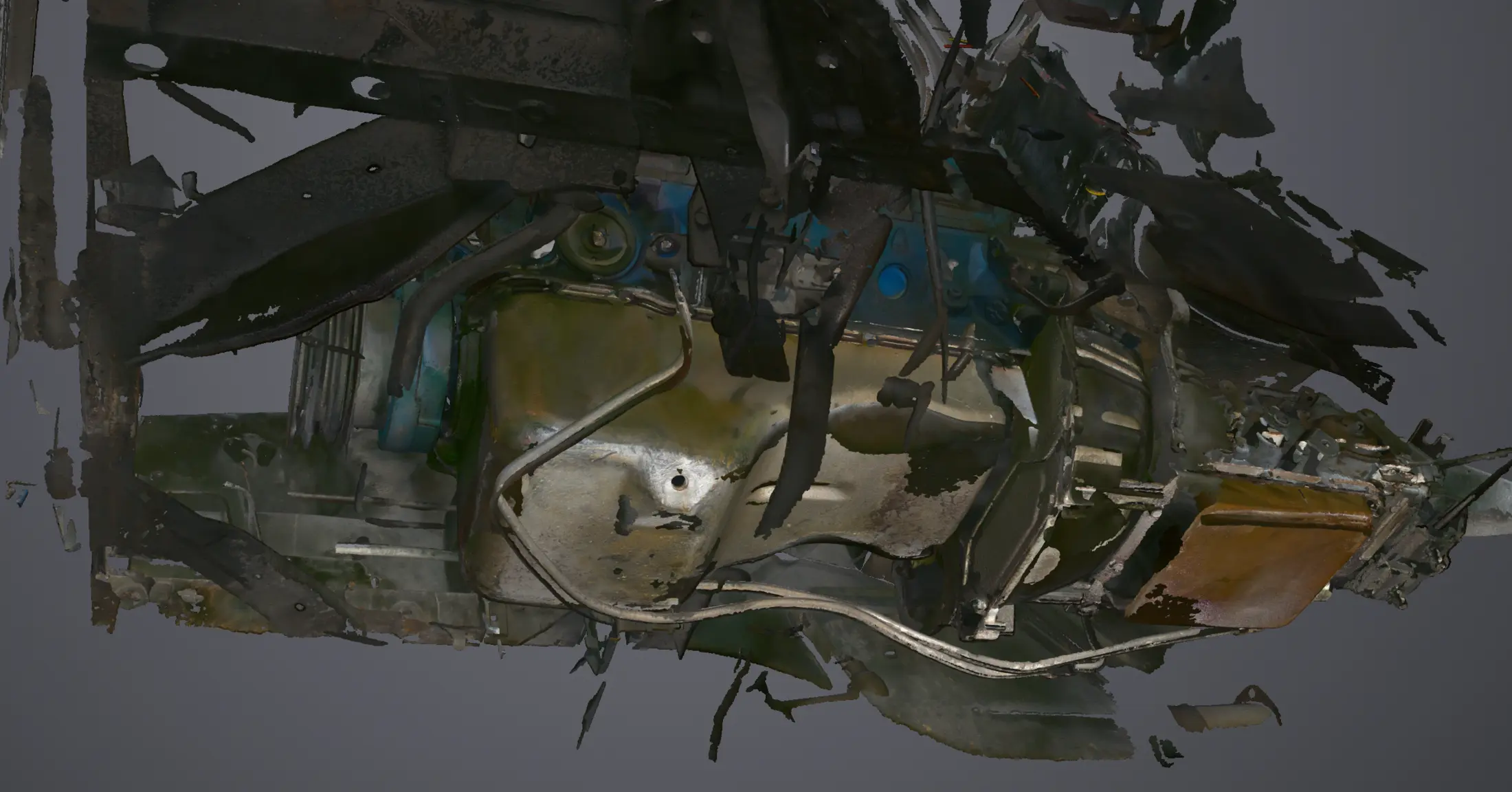

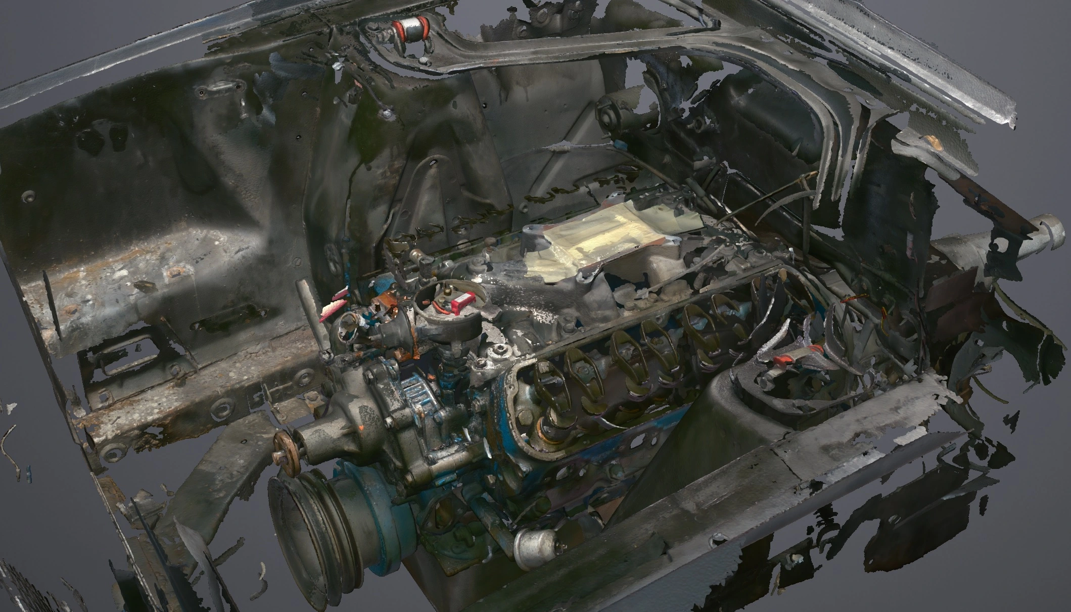

Current course of action: people say the 4.6L is wider than the 5.0, so instead of flailing about with a tape measure, I’m employing a 3D scanner with 0.1mm precision.
I scanned 289 right inside the engine bay, then pulled it out and scanned both the bay and the engine on the hoist.
That gave me an aligned 3D view - like automotive X-ray specs - of exactly how everything fits. Good for a swap novice like me

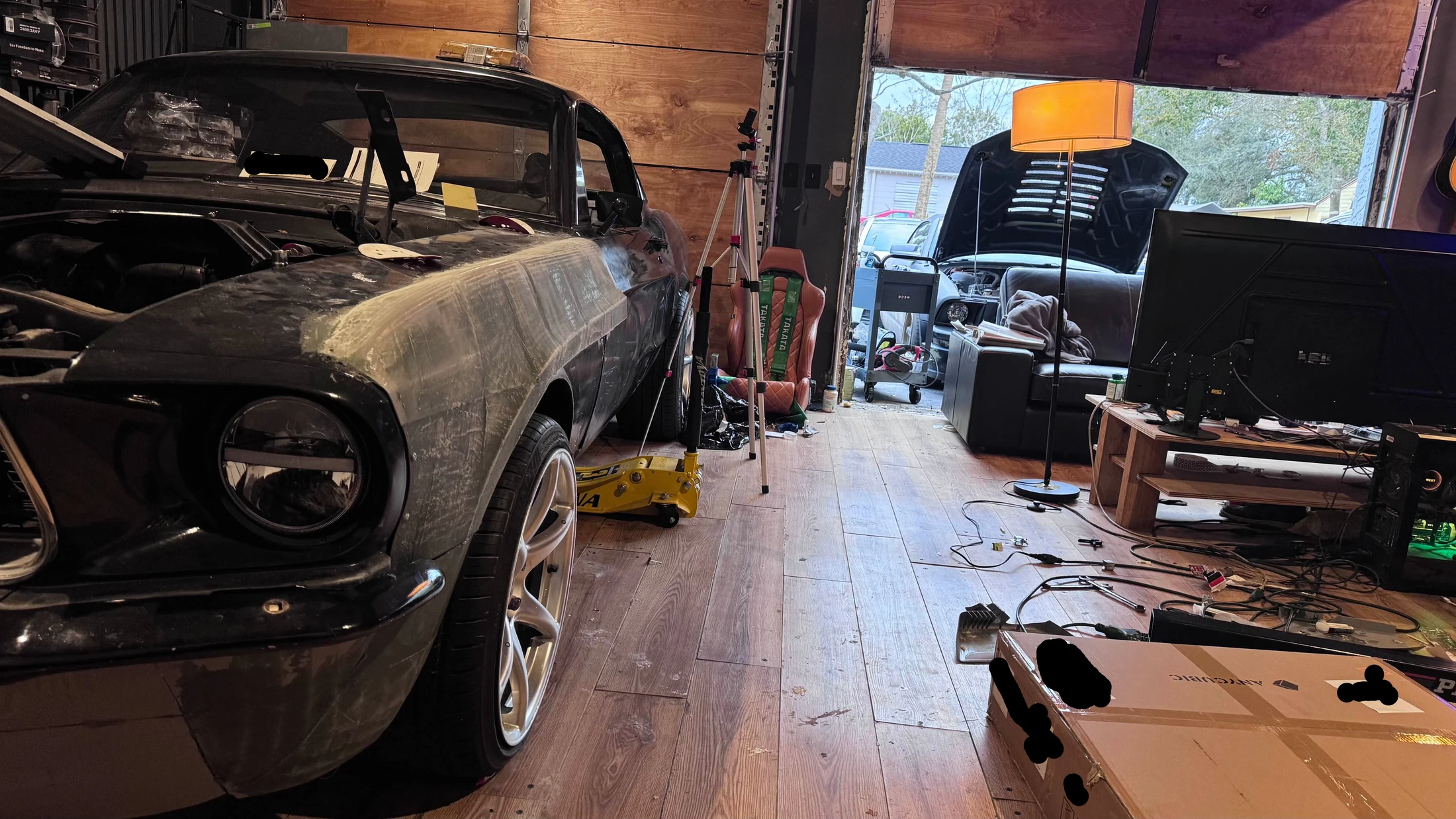

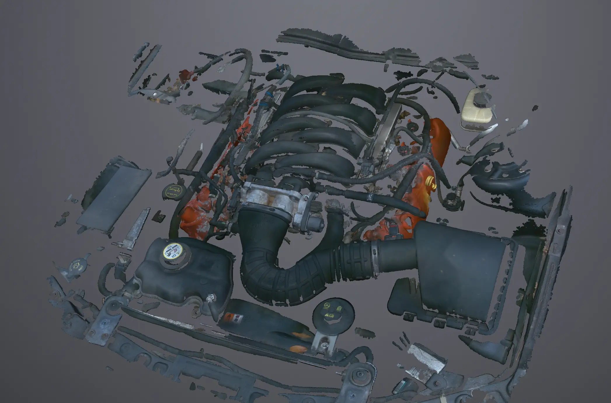

Then I parked GT in front of my garage unplugging hoses, labeling cables, and quickly 3D scanned the engine bay to make myself busy tonight

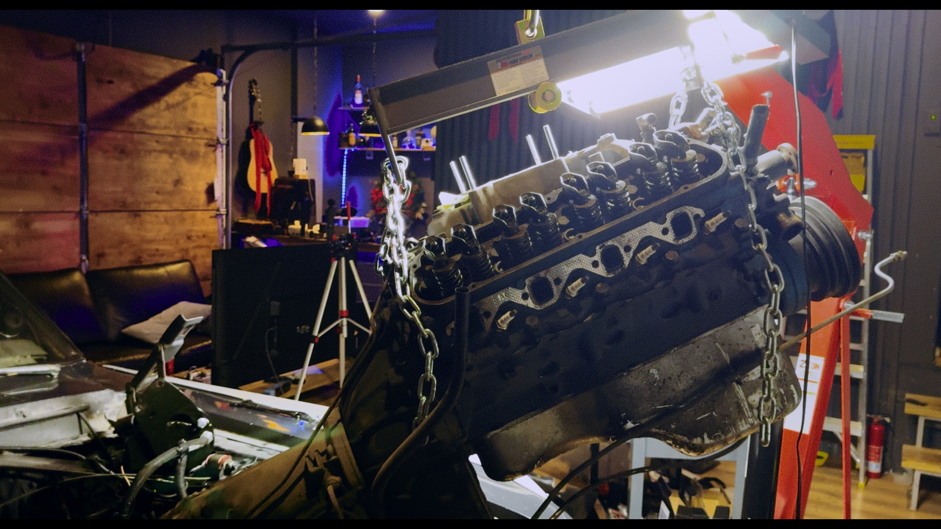

This weekend I’ll yank out the 4.6L, will do detailed 3d scan it mid-air, scan the now-vacant GT bay, and see if the entire front and rear suspension can be grafted onto my ‘ex-coupe-to-fastback-turned-retrofuturistic-wonder.’ It’s only an inch shy of the GT’s width, so maybe I’ll slice and dice until it fits - or possibly just plonk in the engine and transmission. The 3D fitment results will decide my next move.

It might be a little late, but I'd also suggest taking a tape measure and measuring the tightest gap between the engine and the strut towers in the late model. Then once the engine is out I'd measure between the strut towers at those points. I'd then compare those numbers to the distance between the shock towers in the 67. That would give you a second set of numbers for clarification as well as confirming what you've scanned.
