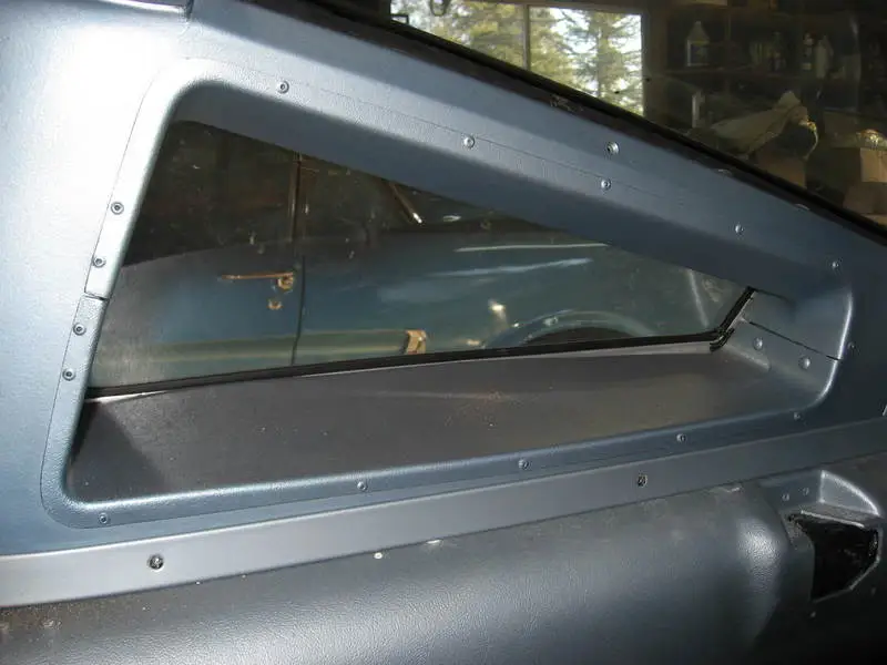

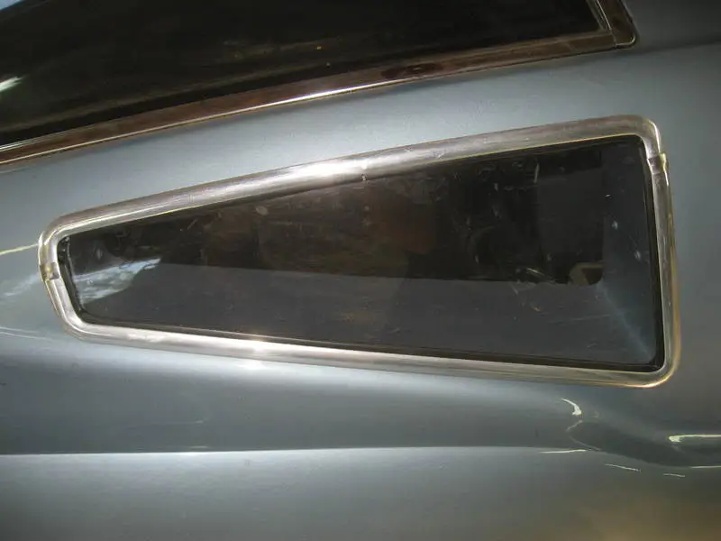

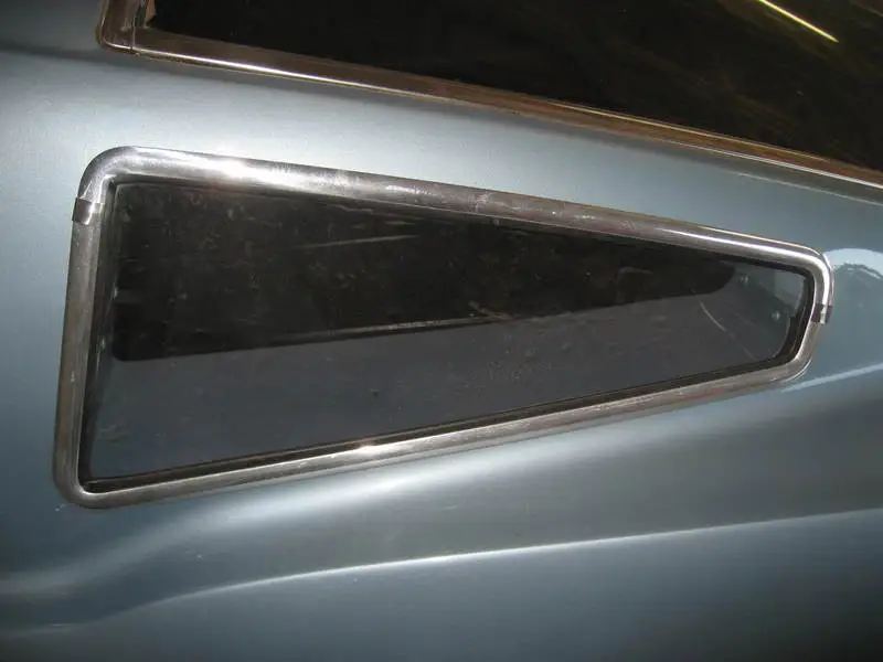

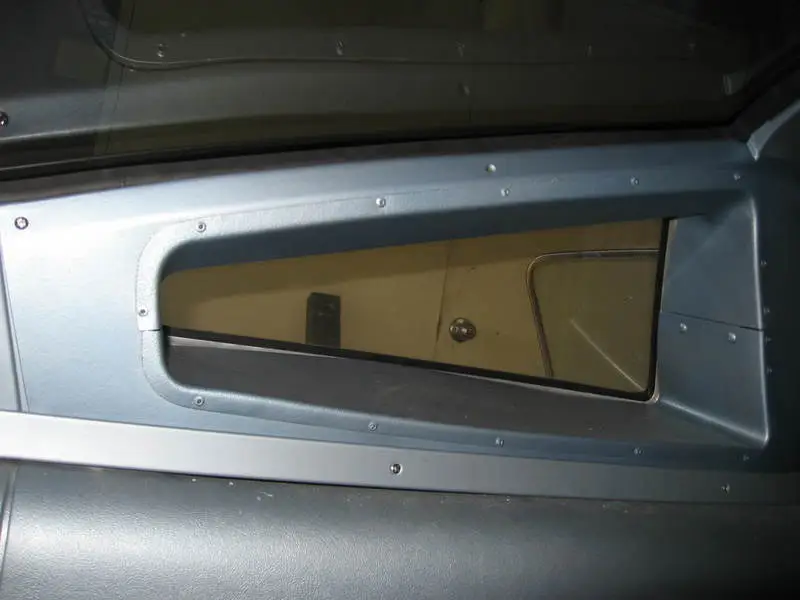

A few pictures of the finished window installation. You can see some warpage in the inner panels. I have always liked the look of the vents but hated the blind spot. I like the look of the window too and it almost eliminates the blind spot.
Notice the little pile of dust in the middle of the lower panel. This is ash from the Oct. fires. If ash can get through, water can get through. These aren't as sealed as I thought they were.
This is the outside of the other window. You can see the ash here too. It is directly below the gap in the rubber gasket. I used glazing putty applied with a caulk gun but it still leaks.

Man, that's fantastic. Any chance you have any in progress pictures while they were being installed?
THanks so much regardless. It's great to see the detail up close. Any suggestions on how to keep them from leaking? Not a real huge concern as I can't imagine this car would knowingly be driven in the rain...

Unfortunately I didn't think to take pictures of the installation process. The leaky windows don't bother me because as you said I don't plan to drive the car in the rain. Of course the first time I drove it more than a mile from my house it began to rain. I imagine more goo around the gasket would help but it's too late for me now. These really aren't designed to come off.
i did it like the others said got worl it to make it fit, the kit i had the glass was too large and the plexglass cracked when i was trial fitting but i just made them out of lexan instead im gonna use bedding glazing compound for the alum to body seal.
