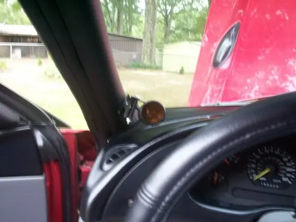

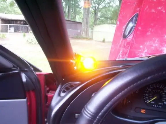

proform adjustable rpm shift light is what you need.
Sounds good Chris.
You can even stash it behind a vent (if that works for you, peripherally) for a sleeperish look.
It seems to me you can even grab the tach signal at the stock tach perhaps (I'd have to try this myself to know for sure) - this would save running wires.
Good luck.
