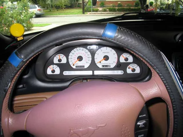

this is how i have mine.........

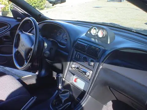

mine is in the corner top left can you see it ...???? i can change the bulbs and rev limit for the light...it helps alot during brake stands..
