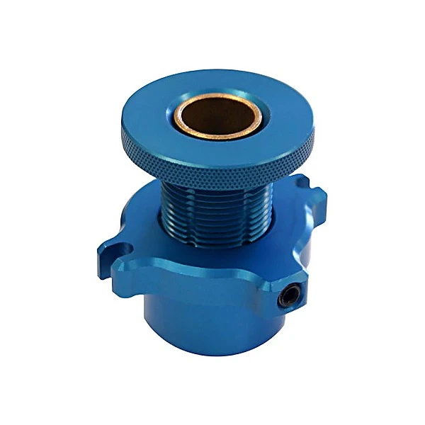

Thanks I do have the steeda adjustable cable with the aluminum quadrant. I adjusted a few turns out and it seems to be fine but we're having a tropical storm rolling in so I won't be able to take it out and drive it for a day or two.
