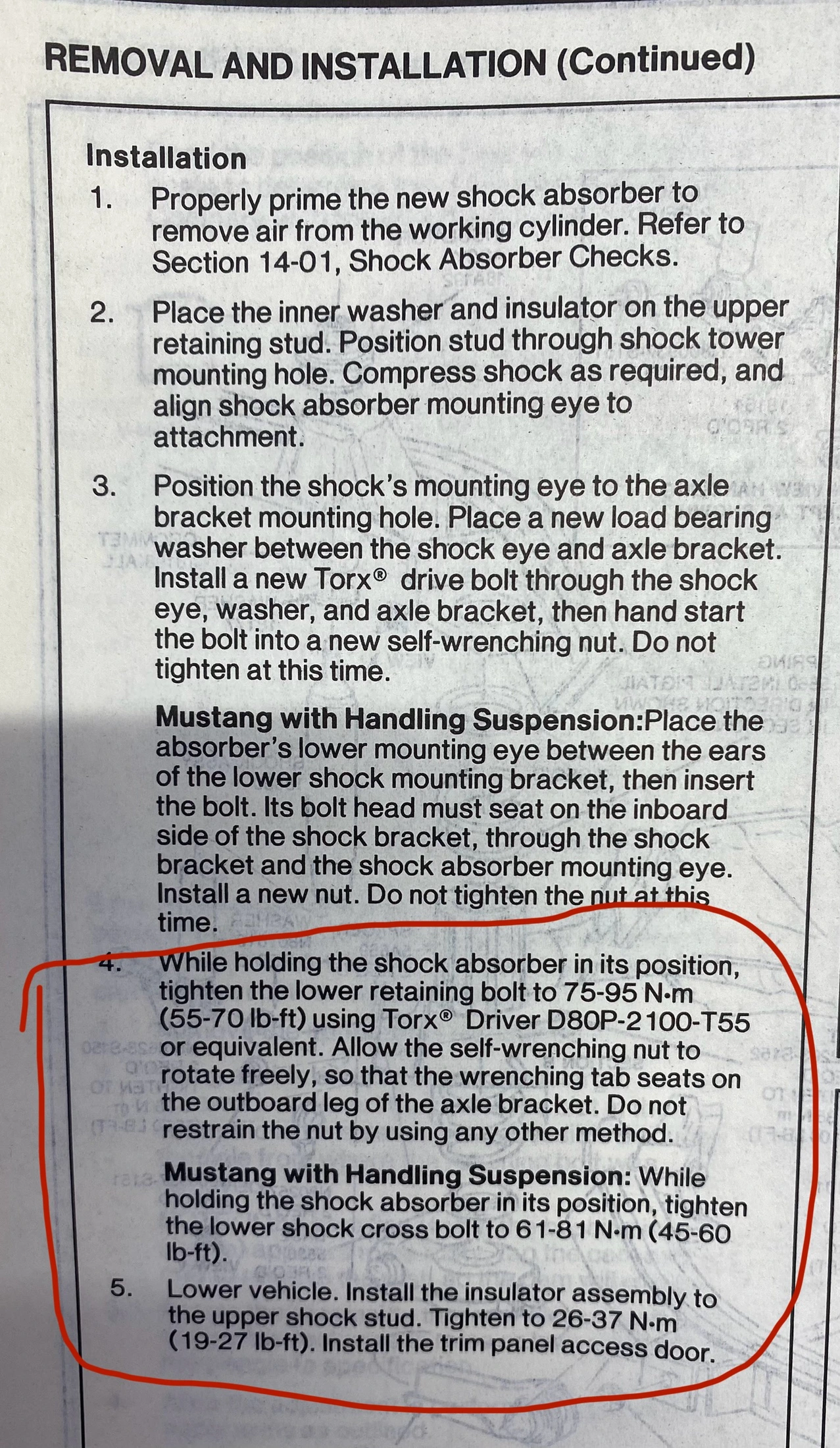

DemonGT Founding Member May 24, 2002 871 51 49 Sparta,WI Feb 10, 2025 #1 Feb 10, 2025 #1 When installing the rear shocks how tight to you tighten the top nut? Is there a torque spec for it or just until its snug?

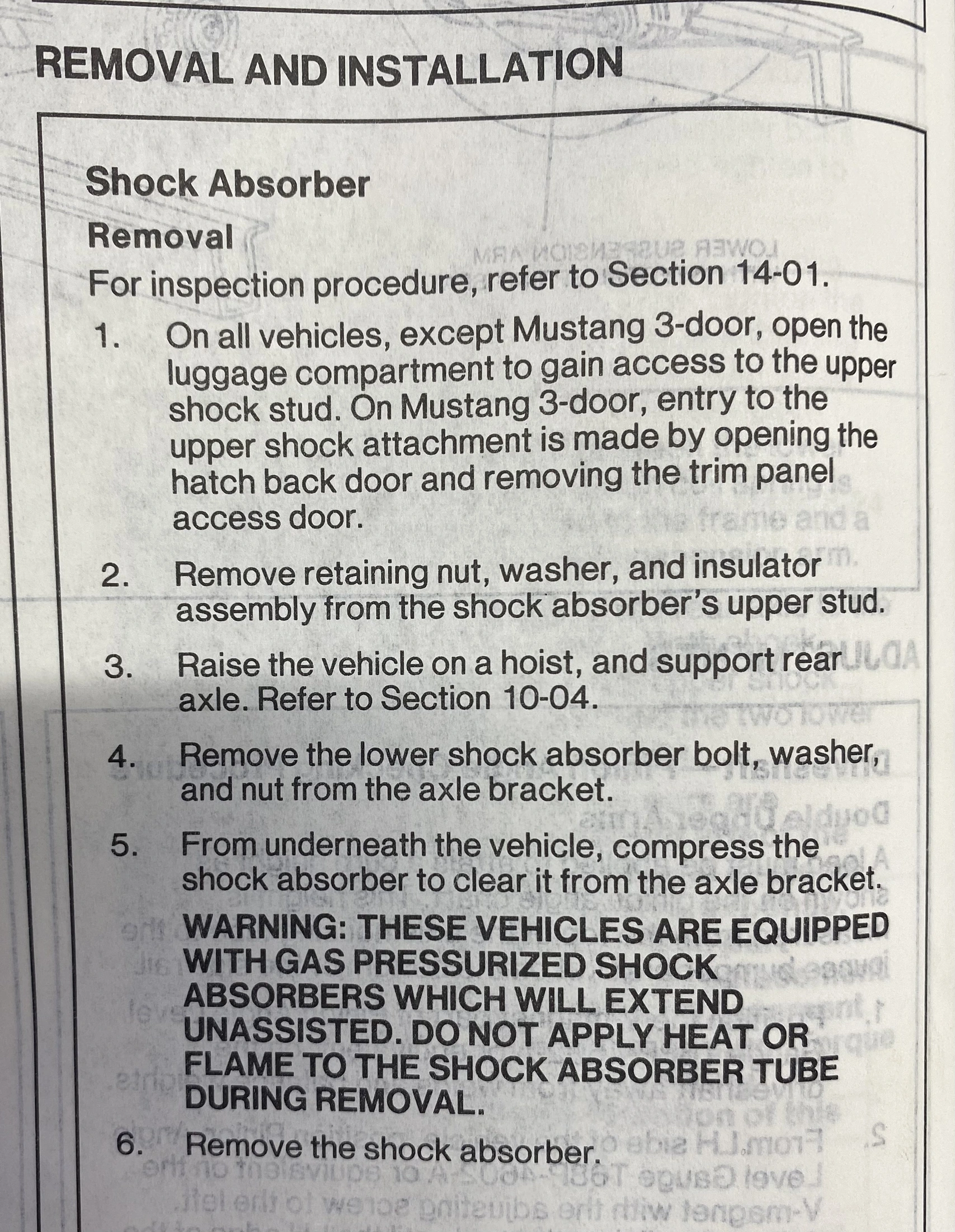

91AOD5.0LX I have a slight sag in my rear 5 Year Member Feb 20, 2021 1,092 1,035 133 Lake George NY Feb 10, 2025 #2 Feb 10, 2025 #2 Hope this helps. Taken from the 1991 Ford shop book Reactions: Wayne Waldrep, THNX SVT, 89ripper and 2 others
