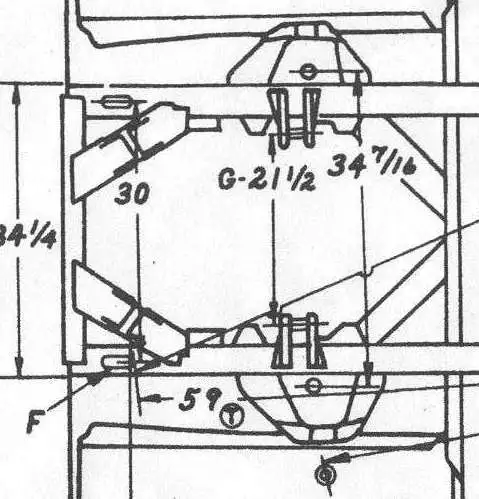

Here's a (part of) a frame chart drawing. It's for a 65 Mustang, but since Export braces are listed to fit all 65-70 Mustangs, I would assume that the 34 7/16" measurement should apply to your car also.
The adjustability of a brace like TCP's is nice, but with a regular one (provided it's made correctly) you can check the state your shock towers are in.

Thanks for the diagram, thats exactly why i went and dug out the old one. As soon as i layed the TCP plates oer the shock tower i knew there was a problem.
