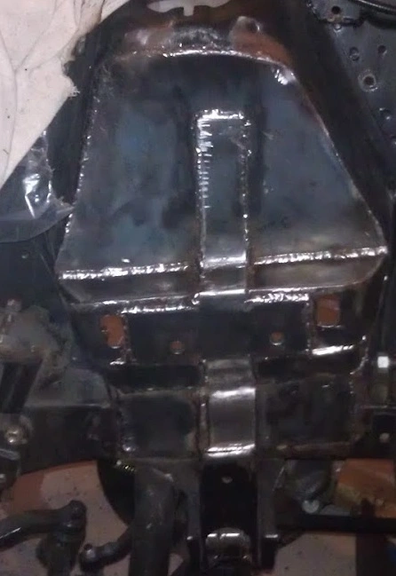

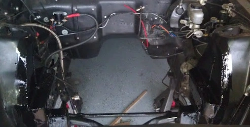

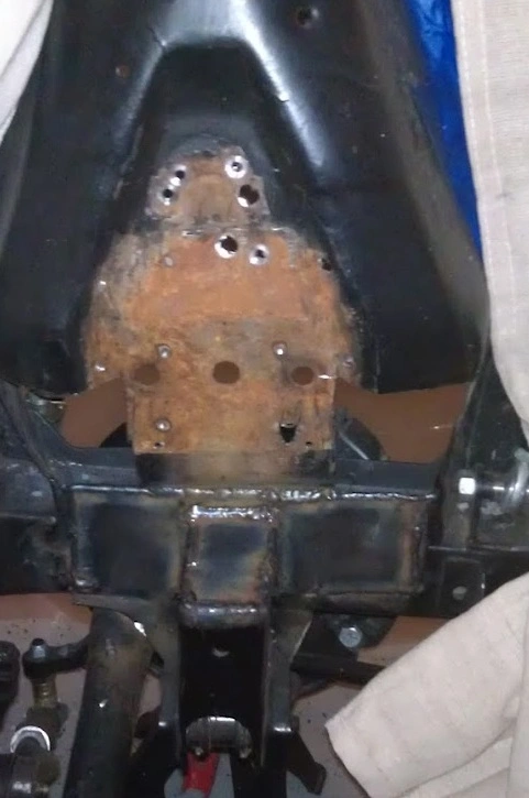

Attached is what I've done so far. I got TCP UCAs with the drop arms and flipped them so the bolt holes would be lower. I had to cut holes for the heim joints to fit. I'll post more pics when I get paint on them. I've also got some pics of the header clearance before I did this, will post some comparison photos when I get the motor back in.

The pivot shaft arm itself is in the same location as a shelby drop (1" lower than stock). The bolt holes are underneath the pivot arm, rather than through the middle. They are made to drop the arms without having to drill holes (I flipped them instead to bolt them up from the bottom).

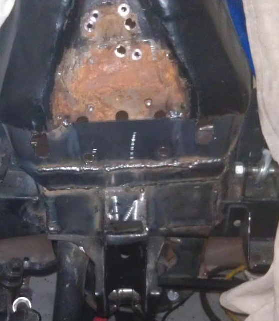

24.5" between where the pivot shafts bolt up, and 28.5" between the middle parts. will post pics when I get the motor back in.

I had the same concerns when i was running my 351W. I had the Hedman swap headers and they were tight. Once you remove the towers you'll have plenty room. Actually it'll make the motor look small.LOL. Later on down the road the possibilities of a new engine & drivetrain are endless.
I should have the motor in this weekend. The coil over shocks from moneymaker will be in Wednesday. I've got some C-460 heads I was trying to sale to fund a new short block. Seems no one wants them, maybe I can stick a BBF in it now.
