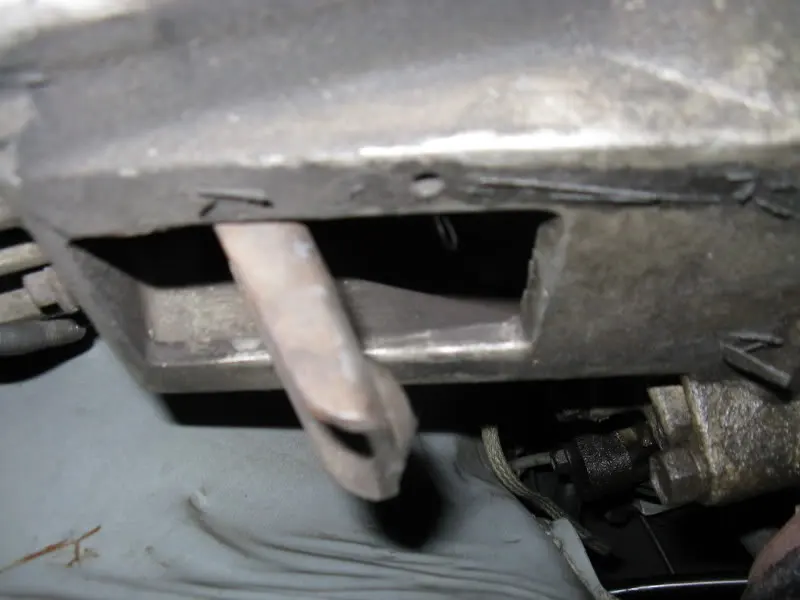

Here is where the clutch fork sits when the TOB contacts the pressure plate

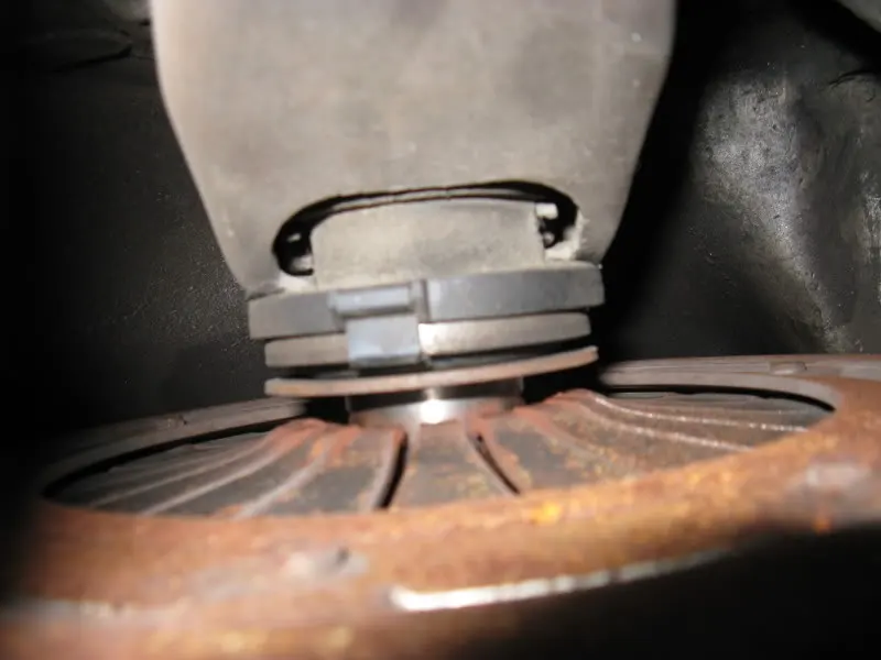

And here is the interior view when it contacts the pressure plate
And here is the interior view when the clutch fork is pulled all the way to the rear.
I know there's some rust there... but does this look like the PP is gone?
Nothing looks amiss as far as I can tell. :shrug: No unusual wear spots or broken bits that I can see.
