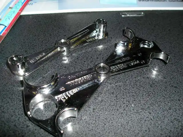

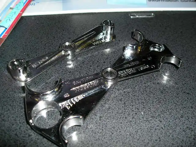

heres a picture of the tool also you need to depressurize the system before you work on it.... you need to do a scouting mission before you buy it (you may not need it) just to get an idea. i forgot the exact size. :nonono:

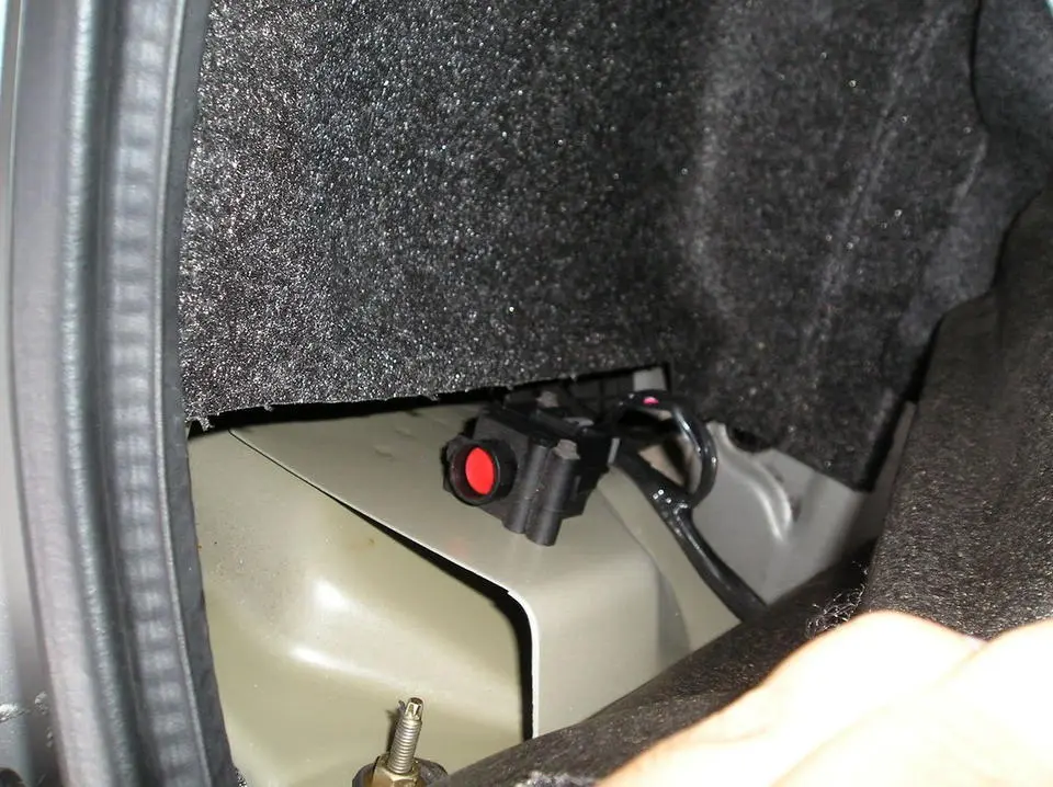

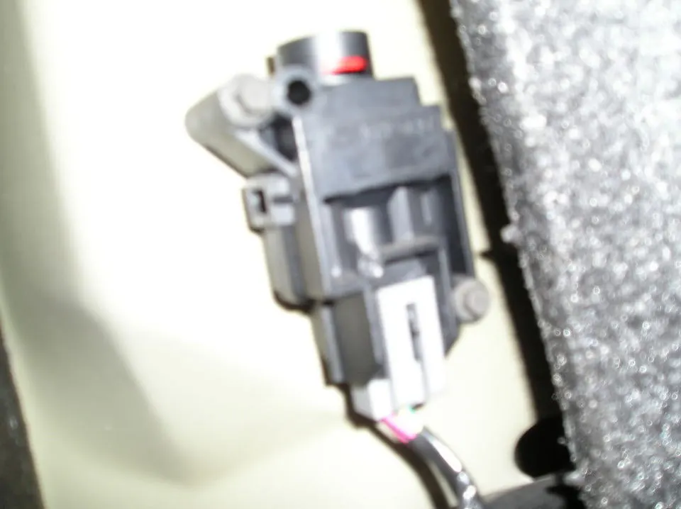

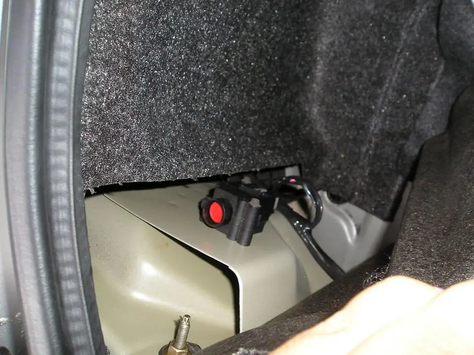

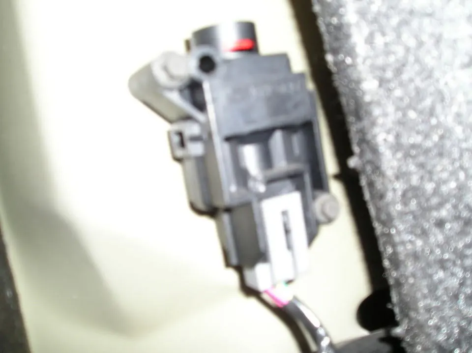

there a moduel in the trunk area that is a reset button (driverside) for the fuel system if it shuts off. the plug almost resembles the MAF wiring clip in the front. dissconnect the clip from the reset button, that will turn turn off the fuel pump. once thats done
turn the car on and let it run. now it will do 1 of 3 things. 1 it wont fire 2 it will start then after 30 or so secs will die or 3 fire and keep going. if the 3rd one happens pay attention to the exhaust note. if it starts to sound like its cammed like a nascar racer shut it down. because at that point the system is depressurized and the engine is sucking the fuel in on its own without the aide of the fuel pump.
once that is done disconnect the battery lift the rear end to get some comfortable clearence to work.
