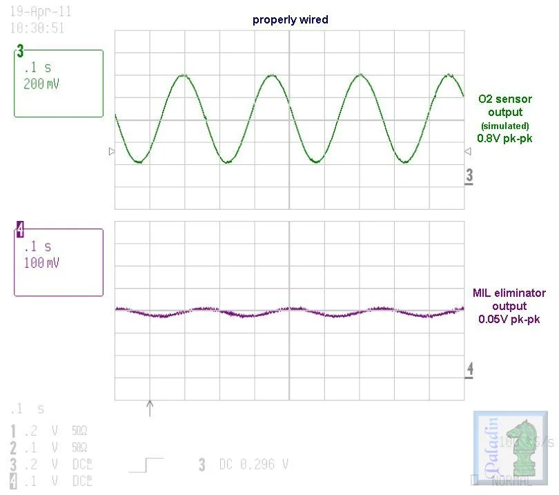

Here's an oscilloscope trace showing a properly wired MIL eliminator:
The MIL eliminator is doing what it is supposed to, reducing the amplitude of the sensor's output from 0.8V pk-pk to 0.05V pk-pk (-24dB at 4.0Hz)

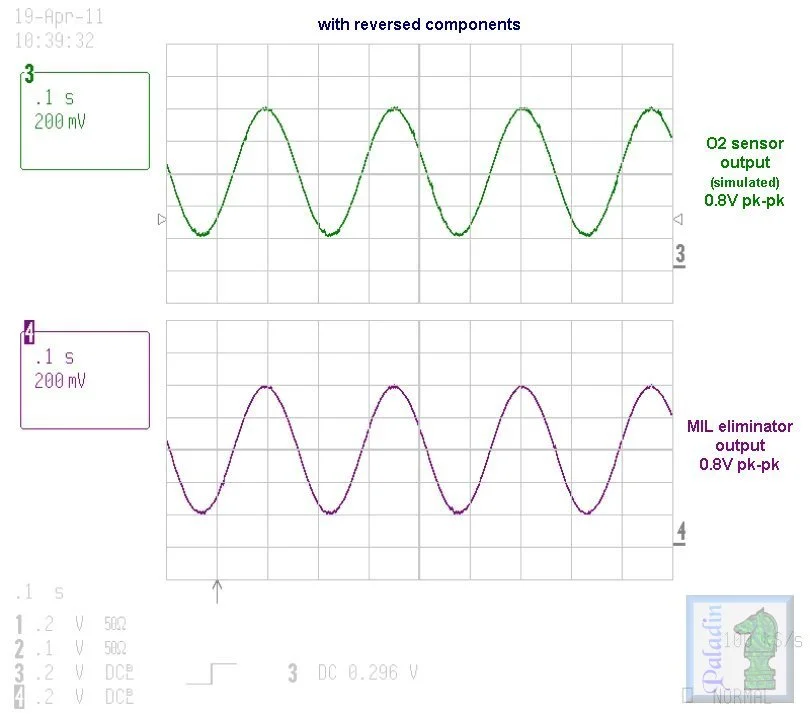

Here is the effect of reversing the components:
Note that the MIL eliminator output simply follows the sensor output.
