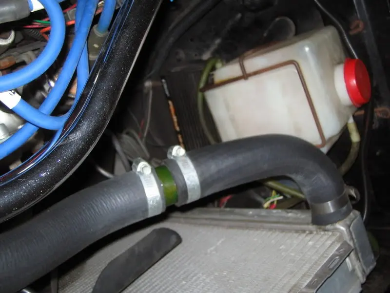

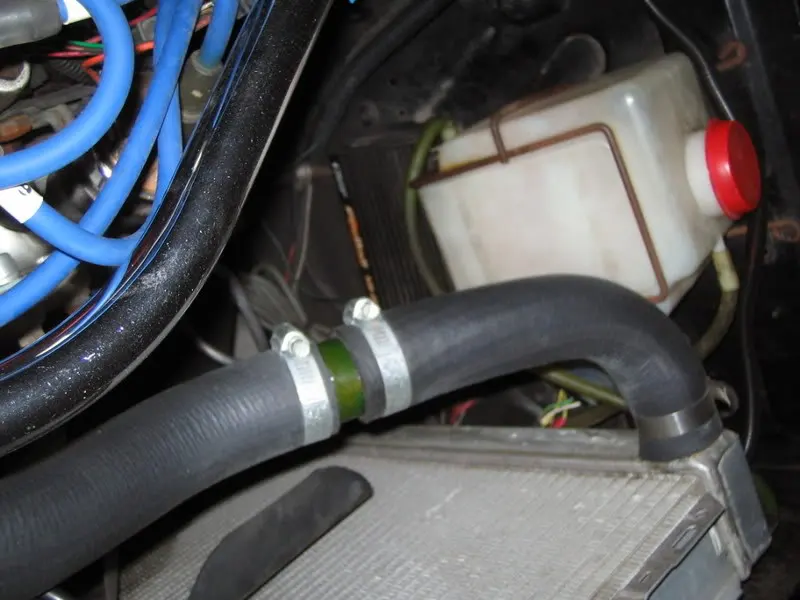

<a href="http://photobucket.com/" target="_blank"><img src="http://i14.photobucket.com/albums/a329/p10socal/Picture003.jpg" border="0" alt="Photobucket - Video and Image Hosting"></a>

I think I spotted the source of your overheating in your photos. Get rid of the filter your have spliced inline with your radiator hose. It not only cuts down on your flow (causing overheating) but could also break (plastic?) or blow off the ends of this plastic piece leaving you stranded or worse (engine failure). If a filter was that important to a cooling system Ford would have them in all their cars from the factory. IMHO
