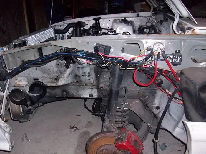

next Q, where did you guys mount your relays and controller?
Eg...good question. I.m still not happy with where I put mine. I might pull the fender liner and mount it in there with the controller and fuse open to where I can access them easily.
I was thinking about putting mine on a plate in the fender where the horn is. depending on how big the relay and controller are and how big the wires are to run everything.
Here is where I put my relay and controller. I had to extend the wires on the temp switch and had to remove the fender but it was just a few nuts and bolts to get it off, pretty simple. I really need to clean this up though.
